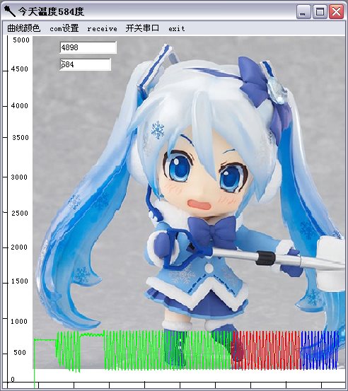

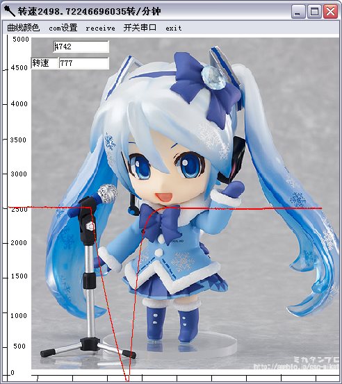

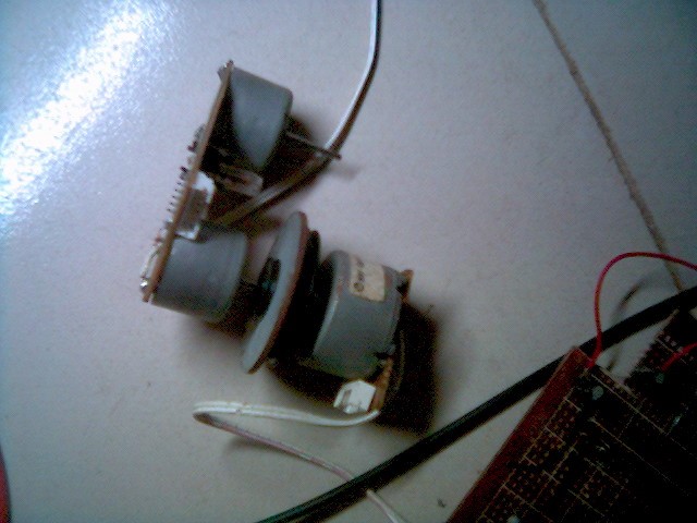

说白了就是采集通过电位器分压的测速发电机的电压发到串口,数据采用%%XXXX的格式发送,TA UART 9600模拟串口
XXXX表是AD数据0-1023
上位机用VB写,串口代码
Private Sub MSComm1_OnComm()
Select Case MSComm1.CommEvent
Case comEvReceive
res1 = MSComm1.Input
t = Trim(res1)
'If (Len(t) < 3) Then Exit Sub
'If (Val(t) > 1024) Then Exit Sub
'MSComm1.InBufferCount = 0
'adc = Val(res1)
ss = InStr(1, res1, "%%")
If (ss < 1) Then
Exit Sub
Else
ssx = Right(res1, Len(res1) - (ss + 1))
End If
adc = Val(ssx)
adc = Val(ssx)
'Yx = ((adc - 673) * 423) / 1024
Yx = adc
'c = Yx
'Y = Yx * 100
Y = Yx * 14.6 / 4.54 '2.27
Form1.Caption = "转速" & CStr(Y) & "转/分钟"
Text2.text = Yx
End Select
End Sub

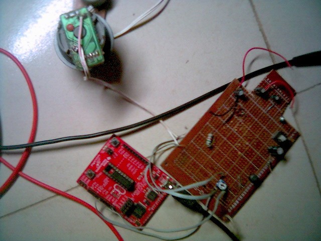

电路:
很简单就是分压电阻,把电压降低,送到AD(P1.7)
测试电机和测速发电机

这个才是温度
