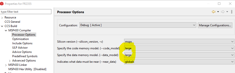

如题同样的代码在CCS 环境下 msp430f2617 编译没有警告,而在msp430fr2355下有警告。怀疑是编译器设置的问题,请教问题出在哪里?代码如下:
unsigned char* addr = 0;
unsigned long addr_value = 0;
addr = (unsigned char*) addr_value;
编译器警告:
Description Resource Path Location Type #173-D invalid type conversion Serial_Cmd_Monitor.c /MSP430FR2355_for_BDC_DRV8848 line 139 C/C++ Problem
