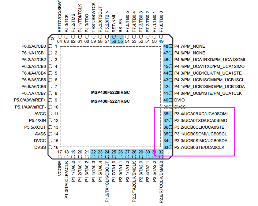

关于msp430F5229 与 cc1120无线发射 spi的问题
Other Parts Discussed in Thread: MSP430F5229, CC1120
在做一个msp430F5229  +cc1120的项目,目前uca0接的是spi flash  ucb0接的是cc1120的spi通讯,将两个spi都初始化了,然后往一个里面写,无法收到数据,例如写了地址读id,不返回数据,但是单个都是可以工作的。
初始化程序如下

//初始化与CC1120连接的spi
void CC1120_SpiInit(void)
  volatile unsigned int i;
  WDTCTL = WDTPW+WDTHOLD;                   // Stop watchdog timer
  P1DIR |= BIT7;                            // Set P1.7 for CSN
  P2DIR |= BIT3;                            // Set P2.3 for slave reset
  P3SEL |= BIT3+BIT4;                       // P3.3,4 option select
  P2SEL |= BIT7;                            // P2.7 CLK
  UCA0CTL1 |= UCSWRST;                      // **Put state machine in reset**
  UCA0CTL0 |= UCMST+UCSYNC+UCCKPL+UCMSB;    // 4-pin, 8-bit SPI master
                                            //Clock polarity high, MSB
  UCA0CTL1 |= UCSSEL_3;                     // SMCLK
  UCA0BR0 = 0x02;                           // /2
  UCA0BR1 = 0;                              //
  UCA0MCTL = 0;                             // No modulation
  UCA0CTL1 &= ~UCSWRST;                     // **Initialize USCI state machine**
  P1OUT &= ~0x80;                           // p1.7 CSN low
  P2OUT &= ~0x08;                           // p2.3 Now with SPI signals initialized,
  P2OUT |= 0x08;                            // reset slave
                                         //The ISR for SPI RX Date/Tx Data
  for(i=50;i>0;i--);                        // Wait for slave to initialize
//  __bis_SR_register(LPM0_bits + GIE);       // CPU off, enable interrupts
//初始化与Flsah连接的spi
void Init_CC1120_SpiFlash()
  P2DIR |= BIT4;                            //CS_N ouput
  P3SEL |= BIT0+BIT1;                      // P3.0,1,2 option select
  P3SEL |= BIT2;                           // P3.2 clk
  UCB0CTL1 |= UCSWRST;                    // **Put state machine in reset**
  UCB0CTL0 |= UCMST+UCSYNC+UCCKPL+UCMSB+UCMODE0;  // 4-pin, 8-bit SPI slave,
                                            // Clock polarity high, MSB
  UCB0CTL1 |= UCSSEL_2;                     // SMCLK
//  UCB0BR0 = 0x00;                           // /2
//  UCB0BR1 = 0;                              //
  UCB0CTL1 &= ~UCSWRST;                     // **Initialize USCI state machine**
