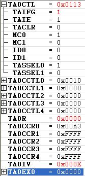

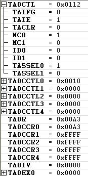

在上述的的测试代码下,调试时分别在上面的两个中断函数里面打断点,发现两个中断都会进去。
进 TIMER0_A0_VECTOR 中断时,寄存器值如下
进 TIMER0_A1_VECTOR 中断时,寄存器值如下
也就是,在 TA0R 被复位时,定时器会产生 Timer overflow 中断。对于这个 Timer overflow 中断感到不理解,因为这个中断处理会唤醒 CPU 进行处理中断操作,影响程序的功耗,应该怎么去屏蔽这个中断,禁止其生成中断,按照我的理解,这里是不应该产生中断的,因为定时器并没有产生溢出。请问该如何处理,才会不产生该 Timer overflow 中断,谢谢!

  • Your final setting of TA0CTL is:
    TA0CTL = TASSEL_1 | MC_1 | TACLR | TAIE;
    That means 65535 ACLKs later, your 16-bit Timer Counter Register will be full and become 0xFFF 0xFFFF (typo corrected). The next ACLK will make it overflow and become 0x0000. Since you also enabled the overflow interrupt by setting TAIE, an overflow interrupt will happen too. This is exactly what happens and it is all your own doing.
    In order to not generate that overflow interrupt, simply change that line of code to not include TAIE in the setting.
