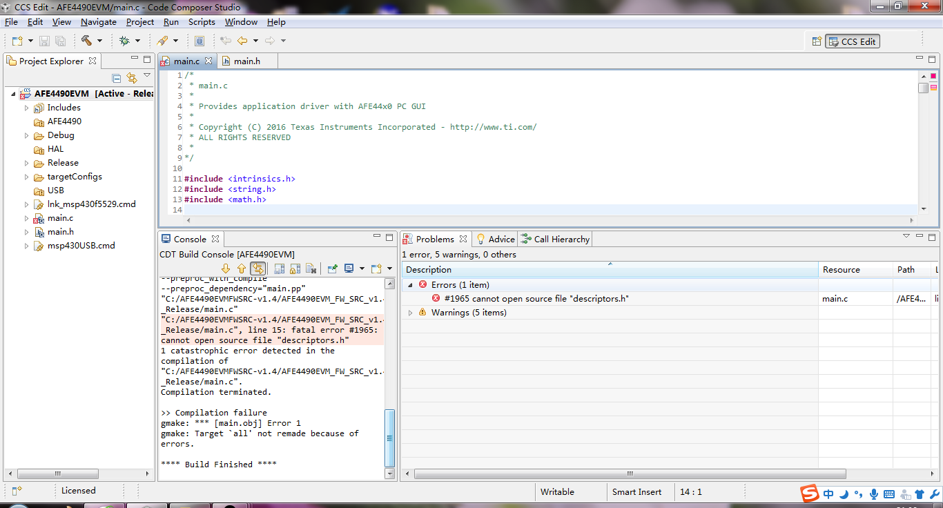

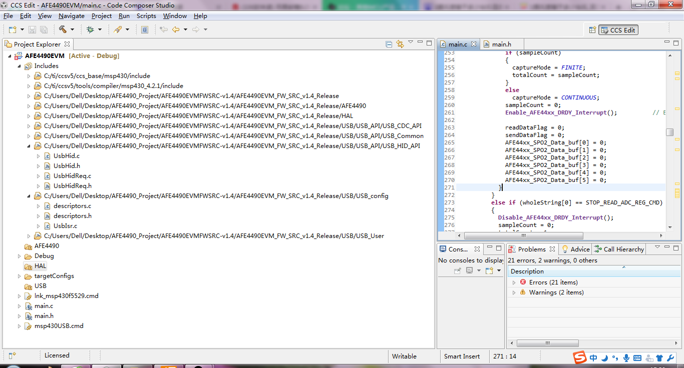

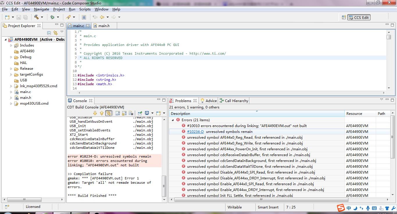

include 添加我也添加了但是还是出现问题,下面附件的图是debug出现的问题,release时出现的则是#include <intrinsics.h>等找不到。请求帮助解答。谢谢!
下面是debug时console的内容:
**** Build of configuration Debug for project AFE4490EVM ****
"C:\\ti\\ccsv5\\utils\\bin\\gmake" -k all
'Building target: AFE4490EVM.out'
'Invoking: MSP430 Linker'
"C:/ti/ccsv5/tools/compiler/msp430_4.2.1/bin/cl430" -vmspx --abi=eabi --advice:power=all -g --define=__MSP430F5529__ --diag_warning=225 --display_error_number --diag_wrap=off --silicon_errata=CPU21 --silicon_errata=CPU22 --silicon_errata=CPU23 --silicon_errata=CPU40 --printf_support=minimal -z -m"AFE4490EVM.map" --heap_size=160 --stack_size=160 --use_hw_mpy=F5 -i"C:/ti/ccsv5/ccs_base/msp430/include" -i"C:/ti/ccsv5/tools/compiler/msp430_4.2.1/lib" -i"C:/ti/ccsv5/tools/compiler/msp430_4.2.1/include" -i"C:/ti/ccsv5/ccs_base/msp430/lib" --reread_libs --warn_sections --display_error_number --diag_wrap=off --xml_link_info="AFE4490EVM_linkInfo.xml" --rom_model -o "AFE4490EVM.out" "./main.obj" "../lnk_msp430f5529.cmd" "../msp430USB.cmd" -l"libmath.a" -l"libc.a"
<Linking>
remark #10371-D: (ULP 1.1) Detected no uses of low power mode state changes using LPMx or _bis_SR_register() or __low_power_mode_x() in this project.
undefined first referenced
symbol in file
AFE44x0_Reg_Read ./main.obj
AFE44x0_Reg_Write ./main.obj
AFE44xx_PowerOn_Init ./main.obj
Disable_AFE44x0_SPI_Read ./main.obj
Disable_AFE44xx_DRDY_Interrupt ./main.obj
Enable_AFE44x0_SPI_Read ./main.obj
Enable_AFE44xx_DRDY_Interrupt ./main.obj
Init_FLL_Settle ./main.obj
SetVCore ./main.obj
USB_connectionInfo ./main.obj
USB_connectionState ./main.obj
USB_disable ./main.obj
USB_handleVbusOnEvent ./main.obj
USB_init ./main.obj
USB_setEnabledEvents ./main.obj
XT2_Start ./main.obj
cdcReceiveDataInBuffer ./main.obj
cdcSendDataInBackground ./main.obj
cdcSendDataWaitTilDone ./main.obj
error #10234-D: unresolved symbols remain
error #10010: errors encountered during linking; "AFE4490EVM.out" not built
>> Compilation failure
gmake: *** [AFE4490EVM.out] Error 1
gmake: Target `all' not remade because of errors.
**** Build Finished ****
下面是release时,console的内容:
**** Build of configuration Release for project AFE4490EVM ****
'Building file: C:/AFE4490EVMFWSRC-v1.4/AFE4490EVM_FW_SRC_v1.4_Release/main.c'
'Invoking: MSP430 Compiler'
"C:/ti/ccsv5/tools/compiler/msp430_4.2.1/bin/cl430" -vmspx --abi=eabi -O2 --include_path="C:/ti/ccsv5/ccs_base/msp430/include" --include_path="C:/ti/ccsv5/tools/compiler/msp430_4.2.1/include" --include_path="C:/Users/a0273681/Documents/Aroul/Projects/Others/F5529/MSP430F5529__Projects/AFE4400-AFE4490EVM_FW_SRC/AFE4490EVM_FW_SRC_v1.4_Release/AFE4490" --include_path="C:/Users/a0273681/Documents/Aroul/Projects/Others/F5529/MSP430F5529__Projects/AFE4400-AFE4490EVM_FW_SRC/AFE4490EVM_FW_SRC_v1.4_Release/HAL" --include_path="C:/Users/a0273681/Documents/Aroul/Projects/Others/F5529/MSP430F5529__Projects/AFE4400-AFE4490EVM_FW_SRC/AFE4490EVM_FW_SRC_v1.4_Release/USB" --include_path="C:/AFE4490EVMFWSRC-v1.4/AFE4490EVM_FW_SRC_v1.4_Release/AFE4490" --include_path="C:/AFE4490EVMFWSRC-v1.4/AFE4490EVM_FW_SRC_v1.4_Release/HAL" --include_path="C:/AFE4490EVMFWSRC-v1.4/AFE4490EVM_FW_SRC_v1.4_Release/USB" --advice:power=all --define=__MSP430F5529__ --diag_warning=225 --diag_wrap=off --display_error_number --silicon_errata=CPU21 --silicon_errata=CPU22 --silicon_errata=CPU23 --silicon_errata=CPU40 --printf_support=minimal --preproc_with_compile --preproc_dependency="main.pp" "C:/AFE4490EVMFWSRC-v1.4/AFE4490EVM_FW_SRC_v1.4_Release/main.c"
"C:/AFE4490EVMFWSRC-v1.4/AFE4490EVM_FW_SRC_v1.4_Release/main.c", line 15: fatal error #1965: cannot open source file "descriptors.h"
1 catastrophic error detected in the compilation of "C:/AFE4490EVMFWSRC-v1.4/AFE4490EVM_FW_SRC_v1.4_Release/main.c".
Compilation terminated.
>> Compilation failure
gmake: *** [main.obj] Error 1
