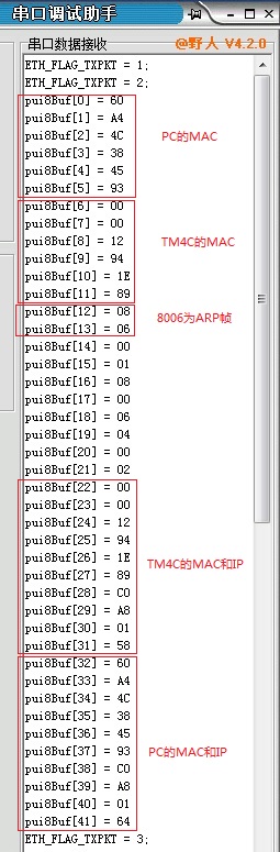

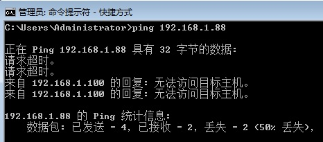

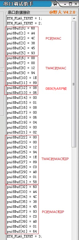

TM4C1294KCPDT移植LWIP2.0.2时发送数据失败
初始化和收发函数是按官方例子enet_lwip、enet_uip改的,代码如下:

uint32_t PacketTransmit(uint8_t *pui8Buf, uint32_t i32BufLen)
    uint32_t i32Loop;
    // Indicate that a packet is being sent.
    ETH_FLAG_TXPKT = 1;
printf("ETH_FLAG_TXPKT = 1;\r\n");
    // Wait for the previous packet to be transmitted.
    while(TxDescriptor[TxDescIndex].ui32CtrlStatus & DES0_TX_CTRL_OWN);
printf("ETH_FLAG_TXPKT = 2;\r\n");
    // Sanity check.
    if(i32BufLen > TX_BUFFER_SIZE)
        i32BufLen = TX_BUFFER_SIZE;
    // Copy the packet data into the transmit buffer.
    for(i32Loop = 0; i32Loop < i32BufLen; i32Loop++)
        TxBuffer[TxDescIndex][i32Loop] = pui8Buf[i32Loop];
        printf("pui8Buf[%d] = %02X\r\n", i32Loop, pui8Buf[i32Loop]);
    // Move to the next descriptor.
    TxDescIndex++;
    if(TxDescIndex == NUM_TX_DESCRIPTORS)
        TxDescIndex = 0;
    // Fill in the packet size and tell the transmitter to start work.
    TxDescriptor[TxDescIndex].ui32Count         = (uint32_t)i32BufLen;
    TxDescriptor[TxDescIndex].ui32CtrlStatus    = ( DES0_TX_CTRL_LAST_SEG  |
                                                    DES0_TX_CTRL_FIRST_SEG |
                                                    DES0_TX_CTRL_INTERRUPT |
                                                    DES0_TX_CTRL_IP_ALL_CKHSUMS |
                                                    DES0_TX_CTRL_CHAINED |
                                                    DES0_TX_CTRL_OWN);
    // Tell the DMA to reacquire the descriptor now that we've filled it in.
    EMACTxDMAPollDemand(EMAC0_BASE);
printf("ETH_FLAG_TXPKT = 3;\r\n");
    // Return the number of bytes sent.
    return(i32BufLen);

ping 192.168.1.88时,串口输出如下:
通过串口打印的信息看,回复的是ARP帧,可电脑好像收不到,导致后面的ICMP一直Ping不通。
求大神帮忙~!谢谢!
    求大神帮忙~!谢谢!
  • hello,有大神在吗?没人帮我看看这个问题吗?
    怀疑是驱动问题,可又找不出是哪的问题,求助呀。。。SOS。。。
        uint32_t i32Loop;
        ETH_FLAG_TXPKT = 1;
        // Sanity check.
        TxDescIndex++;
            TxDescIndex = 0;
                                                        DES0_TX_CTRL_OWN);
        return(i32BufLen);
    求大神帮忙分析一下是什么问题~!谢谢!
