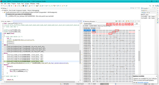

使用RM57L843开发板读写内部flash时,发现写入的数据会出现错误
比如我全写35,但有些地址上的数据会出现错误
写内部flash的代码如下:
void Internal_FLASH_write(uint32 addr, uint8* buff, uint8 len)
Fapi_StatusType oReturnCheck = Fapi_Status_Success;
oReturnCheck = Fapi_initializeFlashBanks(180);
if((oReturnCheck == Fapi_Status_Success) && (FLASH_CONTROL_REGISTER->FmStat.FMSTAT_BITS.BUSY != Fapi_Status_FsmBusy))
if( (addr >= 0x00000000) &&(addr <= 0x003FFFFF) )
if(addr <= 0x003FFFFF)
oReturnCheck = Fapi_setActiveFlashBank(Fapi_FlashBank0);
else
oReturnCheck = Fapi_setActiveFlashBank(Fapi_FlashBank1);
oReturnCheck = Fapi_enableMainBankSectors(0xffff);
else if( (addr >= 0xF0200000 ) && (addr<= 0xF021FFFF))
oReturnCheck = Fapi_setActiveFlashBank(Fapi_FlashBank7);
oReturnCheck = Fapi_enableEepromBankSectors(0xffffffff ,0xffffffff);
while(FLASH_CONTROL_REGISTER->FmStat.FMSTAT_BITS.BUSY == Fapi_Status_FsmBusy);
oReturnCheck = Fapi_issueProgrammingCommand((uint32_t*)(addr), buff, len, 0, 0, Fapi_AutoEccGeneration);
/* Place specific example code here */
/* Wait for FSM to finish */
我的工程如下Internal flash.zip
