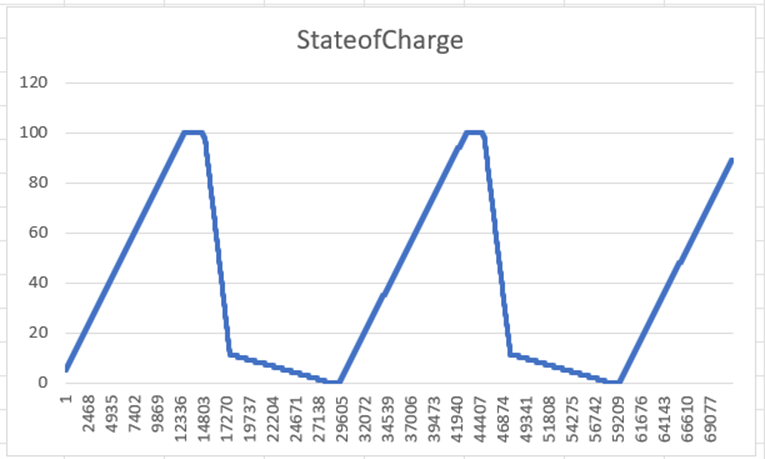

我的PACK是5S6P 使用磷酸鐵鋰電池(Tenpower IFR26700,CHEM_ID=4175)
Golden learning 充放電做完 Qmax有更新到27352mAh、Update Status=06
然後再做兩個充放電循環發現放電載100~11%放電容量很快,11%~0%放電容量趨緩
我已充新做了兩次Golden learning ,結果都一樣,有什麼辦法可以讓放電線比較線性呢?
附上Golden learning完成的.srec檔
My PACK is 5S6P using LiFePO₄ cells (Tenpower IFR26700, CHEM_ID=4175).
After completing the Golden Learning charge/discharge cycles, Qmax was updated to 27,352 mAh and the Update Status shows 06.
However, after performing two additional charge/discharge cycles, I observed that the discharge capacity drops quickly from 100% to 11%, and then slows down from 11% to 0%.
I’ve already repeated the Golden Learning process twice, but the results are the same.
Is there any way to make the discharge curve more linear?
Attached is the .srec file generated after completing Golden Learning.
