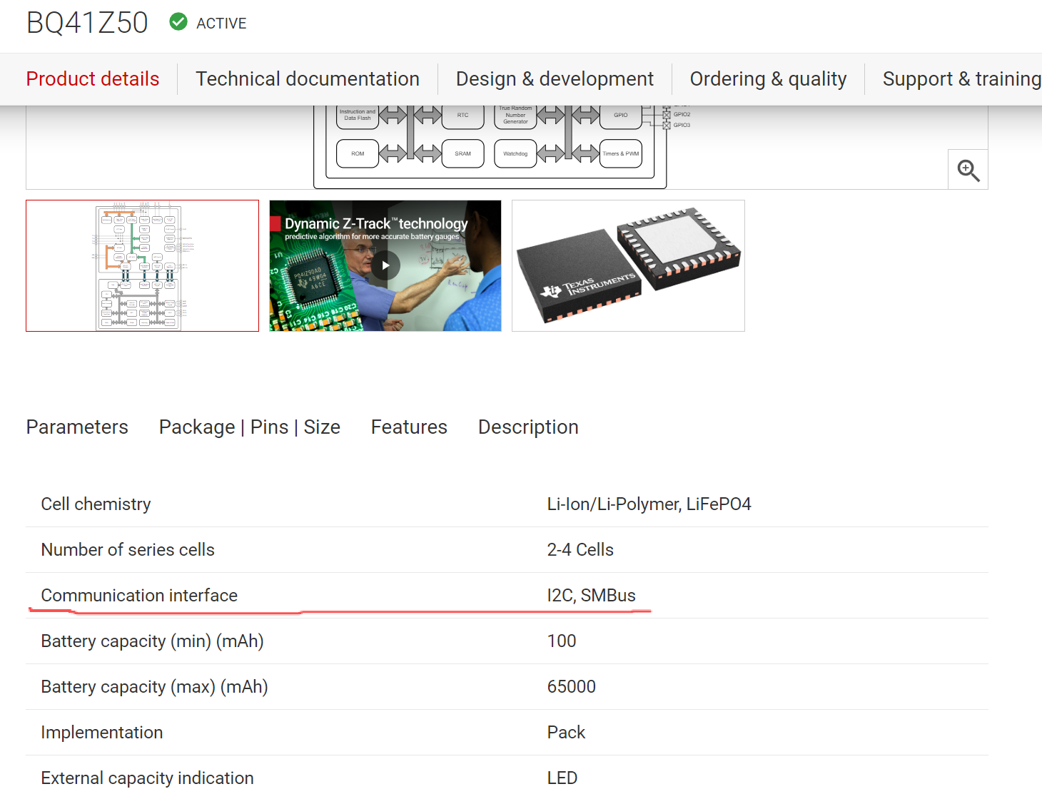

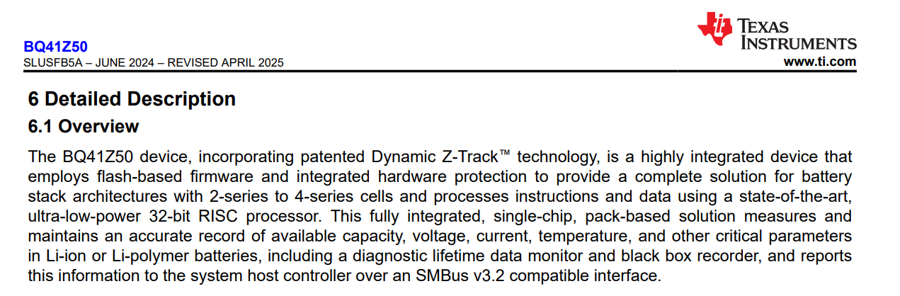

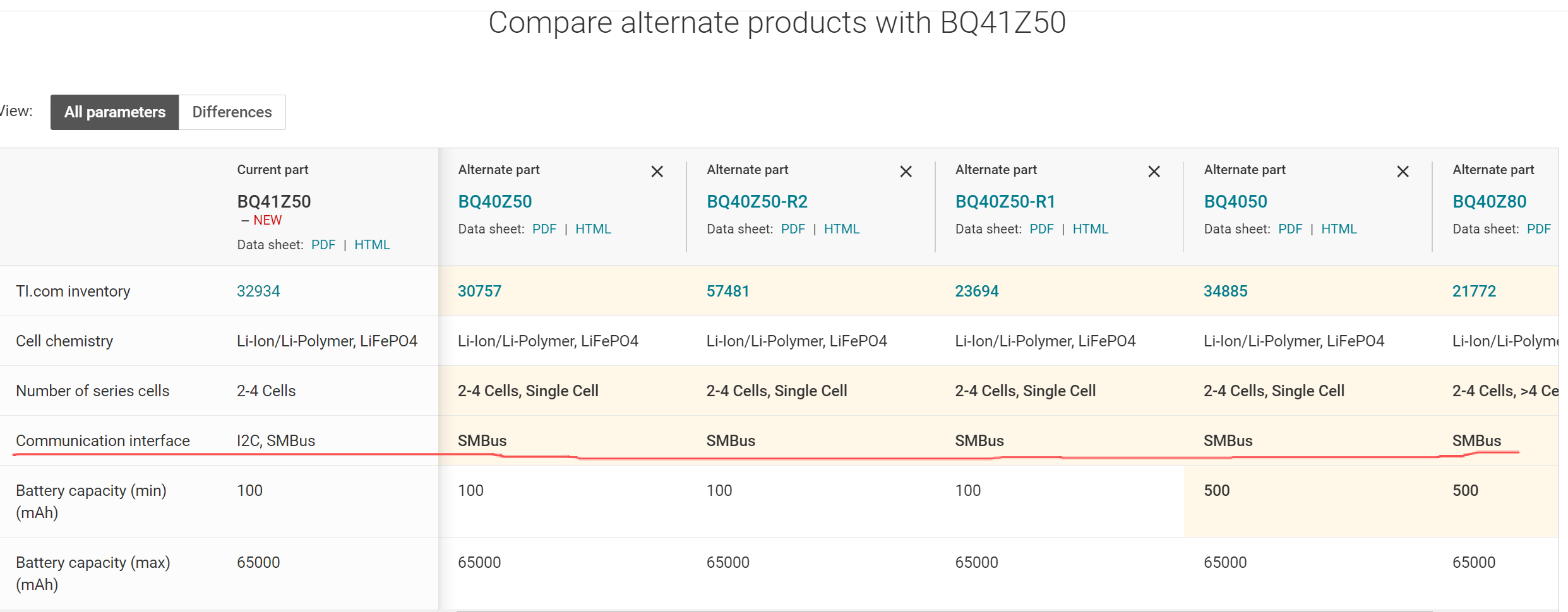

   I discovered an error while selecting the model. The new product BQ41Z50 is marked as supporting I2C and SMBUS in the selection table and the brief introduction, but I could not find any description of I2C support in the datasheet. After inquiring with the supplier, I was told that this chip does not support I2C. I don’t understand why this appears on the page. Could it be that it supports a hidden communication conversion function?
