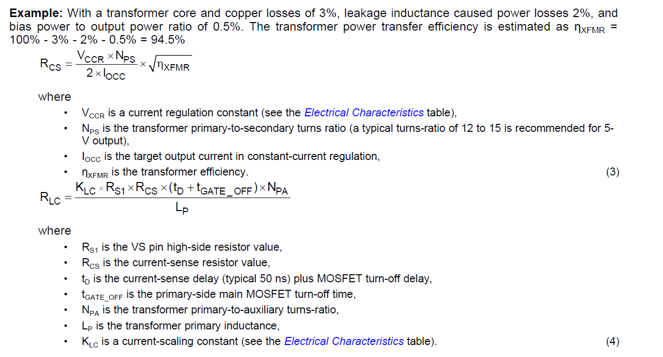

VCCR Constant-current regulating level
Other Parts Discussed in Thread: UCC28704
ucc28704中VCCR Constant-current regulating level怎么理解,rcs与VCCR 的关系怎么理解
