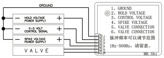

    The spike and hold driver has six screw terminals. They are:
    Terminal 1 - System Ground
    The ground connections for the power supplies and the TTL firing signal are connected to this terminal.
    Terminal 2 – Hold Voltage
    The positive (+) lead from the “hold voltage” power supply is connected to this terminal. The ground (-) is connected to Terminal 1. The hold voltage is the lower of the two voltage supplies. The hold voltage power supply should be capable of supplying 2 watts minimum. Caution: reversing the hold voltage and spike voltage supplies will result in permanent damage to the valve, driver chip, and power supply.
    Terminal 3 – Control Signal
    The positive lead (+) from the TTL control signal (i.e. pulse generator) is attached to this terminal. The ground (-) lead is attached to Terminal 1. The valve will open and remain open as long as the TTL signal is high (5 vdc). The rapidly rising control signal is required to trigger the spike timer.
    Terminal 4 – Spike Voltage (Pulse Voltage)
    The positive lead (+) from the spike voltage power supply is attached to this terminal. The ground (-) lead is attached to Terminal 1. The spike voltage is the higher of the two voltage supplies. The spike power supply should be capable of supplying 20 watts minimum.
    Caution: reversing the spike voltage and hold voltage supplies will result in permanent damage to the valve, driver chip, and power supply.
    Terminal 5 & 6 – Valve Connections
    The VHS valve is connected to these terminals. The coil is not polarized and therefore the leads can be connected in either direction.

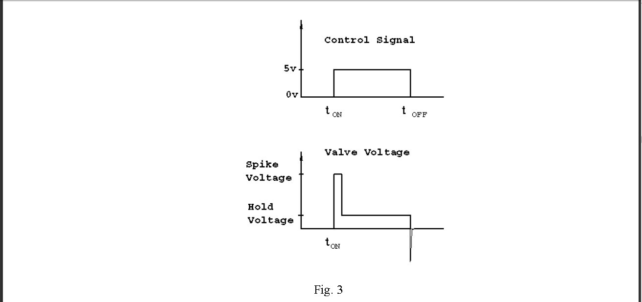

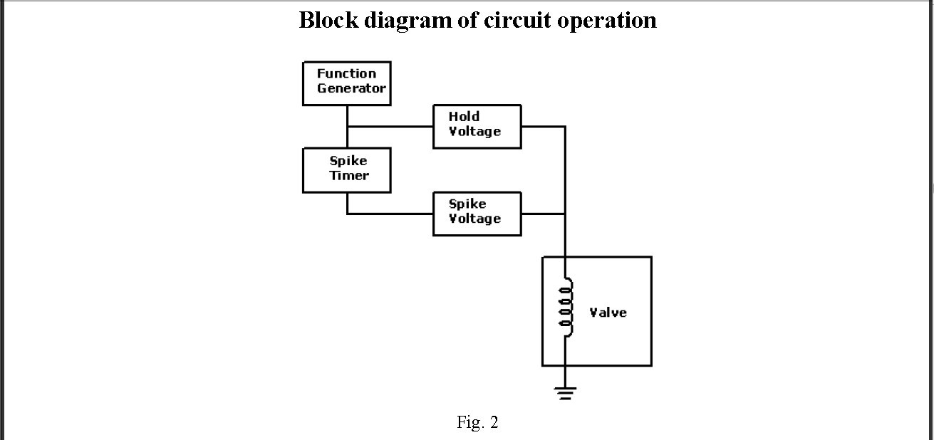

  • Figure 2 shows the operation of the spike and hold circuit. The function generator provides a signal (0 or 5 volts) which acts as the control (trigger) voltage. The on-time, duty cycle and operating frequency of the valve are determined by this input signal. When the function generator control signal is low (0 volts), the circuit and valve are not energized. When the signal goes high (5 volts), the circuit energizes the spike timer, and the hold voltages to the valve. The spike timer is factory preset at 0.30 ms. After the spike time, the circuit turns off the spike voltage and leaves the hold voltage energized for as long as the control signal remains high. When the control signal goes low, all power to the valve is turned off, regardless of the spike timer status.

    The spike duration can be measured by using an oscilloscope with a differential probe, or by hooking up each of the positive leads from two channels of the scope and subtracting Terminal 6 from Terminal 5. The signal will not look right unless there is an inductive load (i.e. a valve). The voltage waveform across the valve should look similar to fig 3. Since the negative spike following shut off of the valve will be about –50 volts, 10X probes may be needed to see all of the waveform.
    Caution: The ground of the oscilloscope should never be attached to either side of the valve. If the ground lead of the oscilloscope is attached to either lead, there will be permanent damage to the valve, driver chip, and/or power supplies.

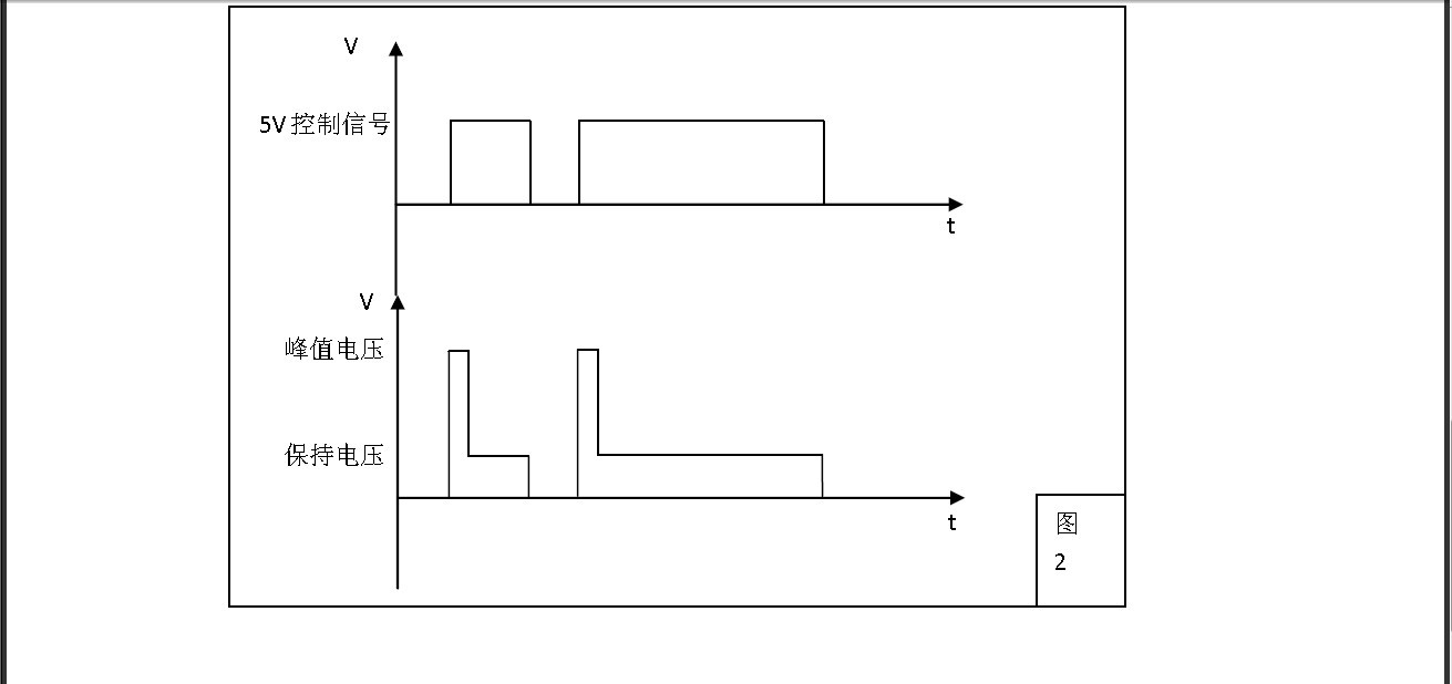

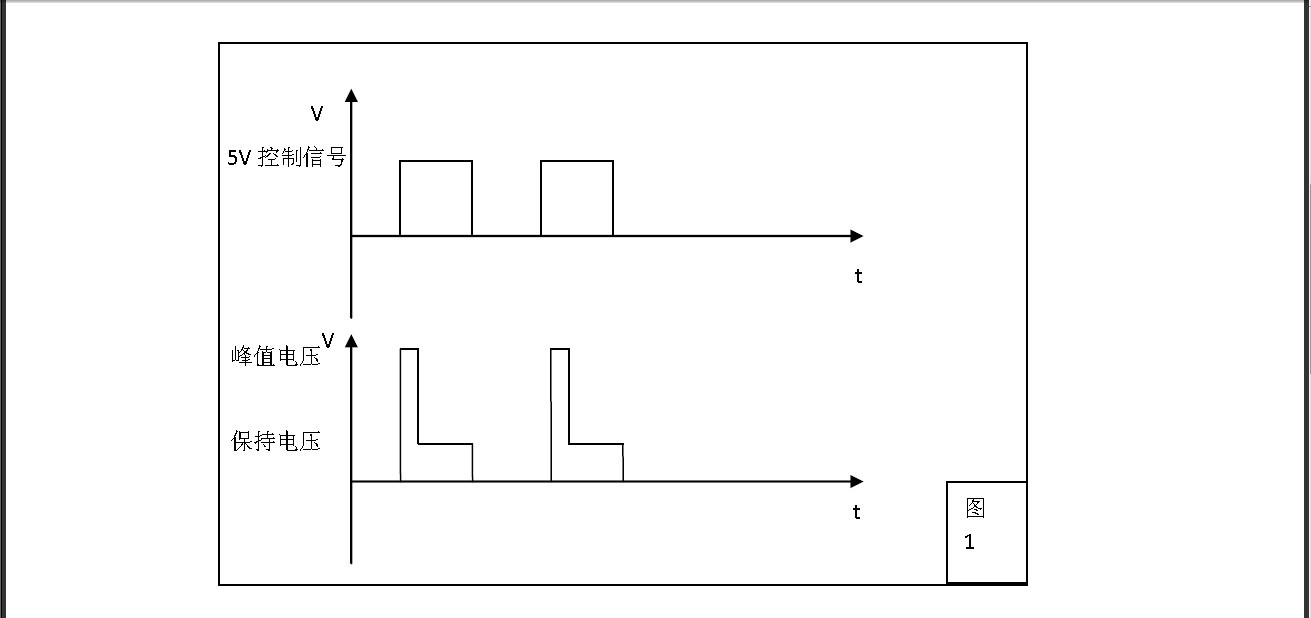

  • 其他补充:
    控制信号: 5V 的TTL信号
    峰值电压
    保持电压
    1、 峰值电压和保持电压要一直处于稳定的供电状态。
    2、 控制信号是控制输出到阀两端的电压的。
    (1) 当控制信号有5V电压时,又输出到阀两端的电压。当控制信号为0时无输出到阀两端的电压。
    (2) 输出到阀两端的电压随控制信号的频率、占空比改变而改变。
    3、 控制信号与输出到阀两端的电压对应关系如下图

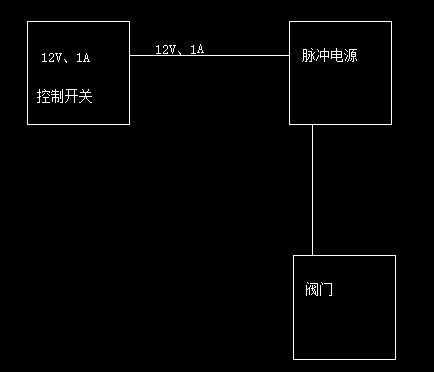

  • 你好,Max Han,您是指这个脉冲的输入电压吗?还有一点我忘记跟您说了,我们这套系统的工作流程是这样的:
    机器给出一个12V、1A的直流电压来控制我们需要的脉冲电源的开关,然后脉冲产生的电源在来控制这个阀门,机器上的12V、1A控制电源闭合,那么这个脉冲电源也需要闭合,阀门也同时停止工作。以下是工作流程图(注:脉冲电源与阀门之间的控制关系见前面的问题的图一)
    另外补充一下,这个脉冲电源如12V、1A功率不够的话,是否也考虑使用外接220V的方式,
