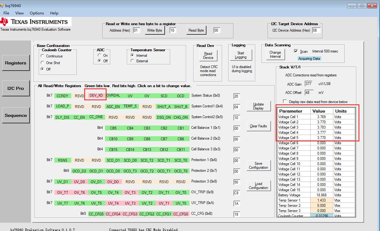

我用EV2300+BQ76940EVM板按照手册bq76930 and bq76940 Evaluation Module User's Guide 操作,连接上了以后,上位机只能显示前面五节的电压,,且DEVICE_XREADY那一位一直是1,且我看了bq76930 and bq76940 Evaluation Module User's Guide手册上,也是显示只采集了前五节,
我量了几个电压点,REGOUT = 2.5V,cap1-vss = 3.3V,cap2-vc5x = 3.3v,cap3 - Vc10x = 0, TS,1,2,3和VC5x,vc10x,也没有电压,
