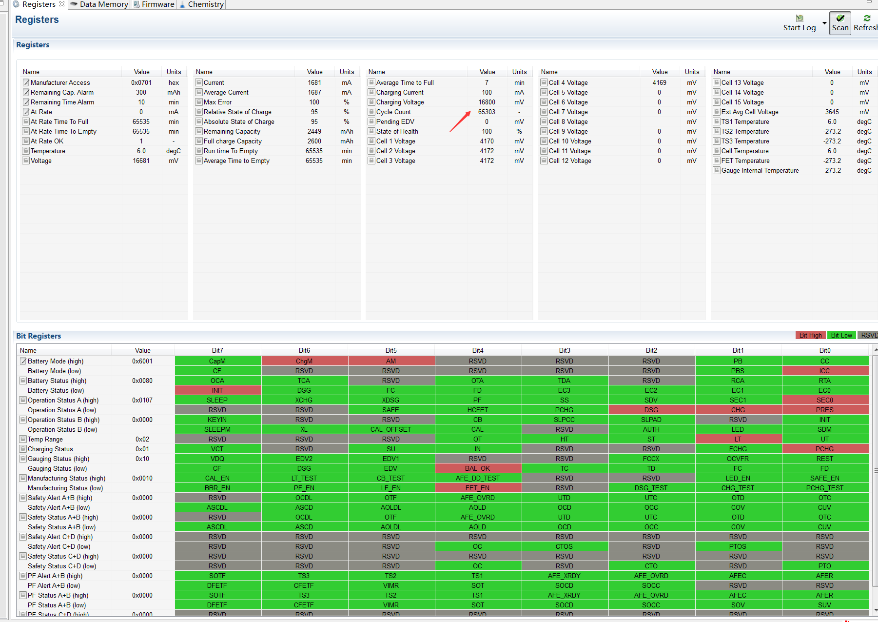

BQ78350 循环次数充着充跳到65303
Genius 3755 points
Other Parts Discussed in Thread: GPCCEDV
请问一下,这个循环次数,是根据什么增加或者减少的?我充电之前改为0的了,但是充着充又跳到65303
  • 关于您的问题您可以参考下面的答复。
    To do current scaling, they need to use the firmware for BQ78350-R2 - it can be downloaded here: www.ti.com/.../BQ78350-R2-DEVICE-FW
    The initial Remaining Capacity and SOC at power up (or with Reset) are determined from the ChemID. If they have selected a matching ChemID for their battery, it will help with SOC accuracy at power-up. Next they need to collect logs for the GPCCEDV tool. If they already did this and they are not seeing accurate results, maybe they can send the output from this tool for me to review. The Design Capacity and the Design Voltage need to be set correctly as well. The full procedure is in this document: www.ti.com/.../slua924
    When they collect the logs for the GPCCEDV tool, it is good to go a little below their desired system cutoff voltage (~100mV), so they may need to widen the protection settings temporarily for the logging process so that the FETs do not open. I noticed there is a CUV fault showing in the picture you attached.
