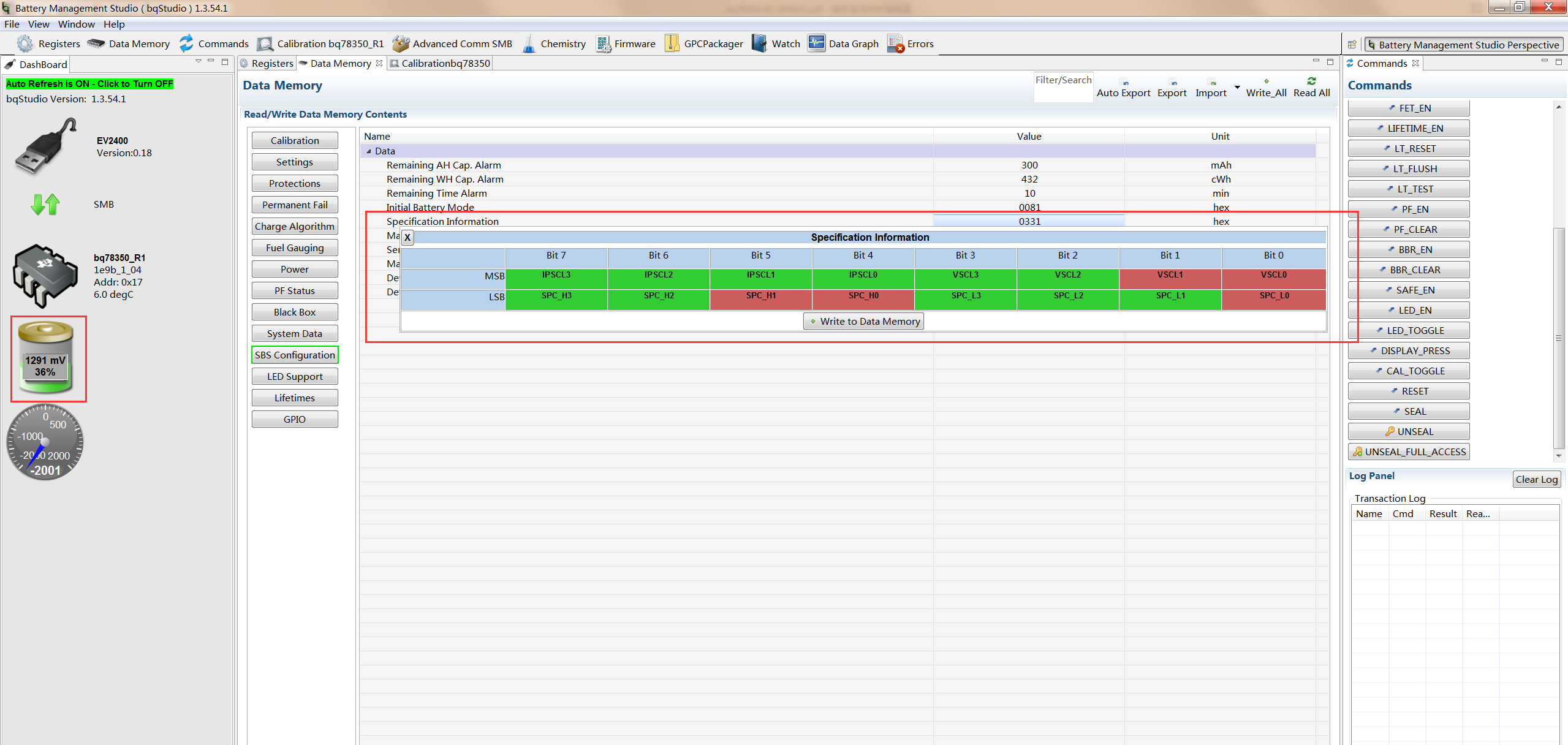

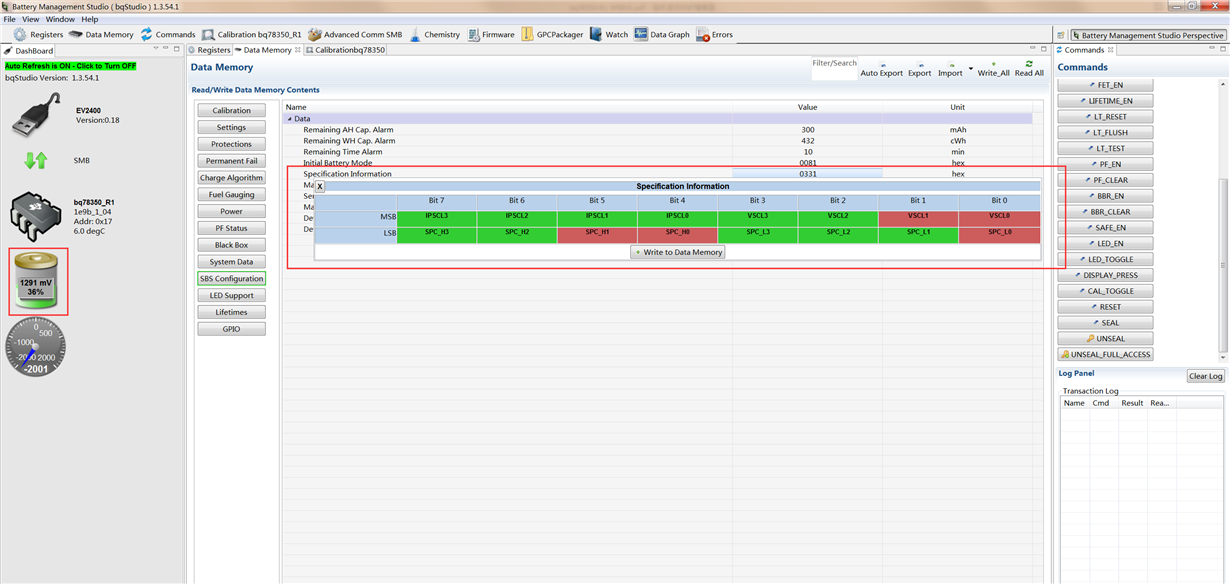

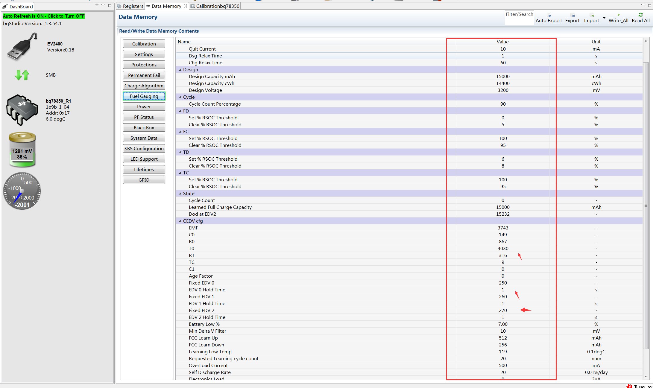

BQ78350 电压/电流缩放10倍后,这些电压/电流是否需要手动填写缩小十倍后的电压,还是按一比一的电压填写?
Genius 3755 points
VSCALE (Bit 11:8): Voltage Scale Factor
0x0 = Voltage() and ChargingVoltage() are scaled by 10E0
0x1 = Voltage() and ChargingVoltage() are scaled by 10E1
0x2 = Voltage() and ChargingVoltage() are scaled by 10E1
0x3 = Voltage() and ChargingVoltage() are scaled by 10E1
