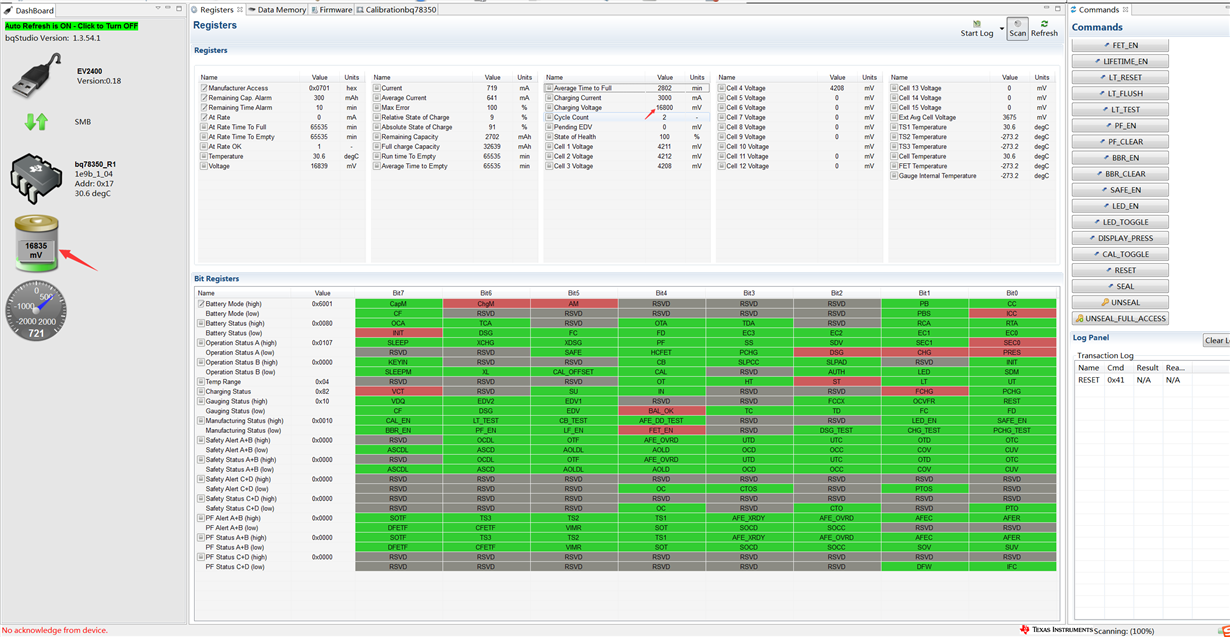

bq78350 充电到达了充电电压,为什么不关闭充电?是哪里没有设置对吗
Genius 3755 points
Other Parts Discussed in Thread: GPCCEDV
  • 在充至%91电量的时候,FCC突然更新为32639
  • The initial Remaining Capacity and SOC at power up (or with Reset) are determined from the ChemID. If they have selected a matching ChemID for their battery, it will help with SOC accuracy at power-up. Next they need to collect logs for the GPCCEDV tool. If they already did this and they are not seeing accurate results, maybe they can send the output from this tool for me to review. The Design Capacity and the Design Voltage need to be set correctly as well. The full procedure is in this document: www.ti.com/.../slua924
    When they collect the logs for the GPCCEDV tool, it is good to go a little below their desired system cutoff voltage (~100mV), so they may need to widen the protection settings temporarily for the logging process so that the FETs do not open. I noticed there is a CUV fault showing in the picture you attached.
