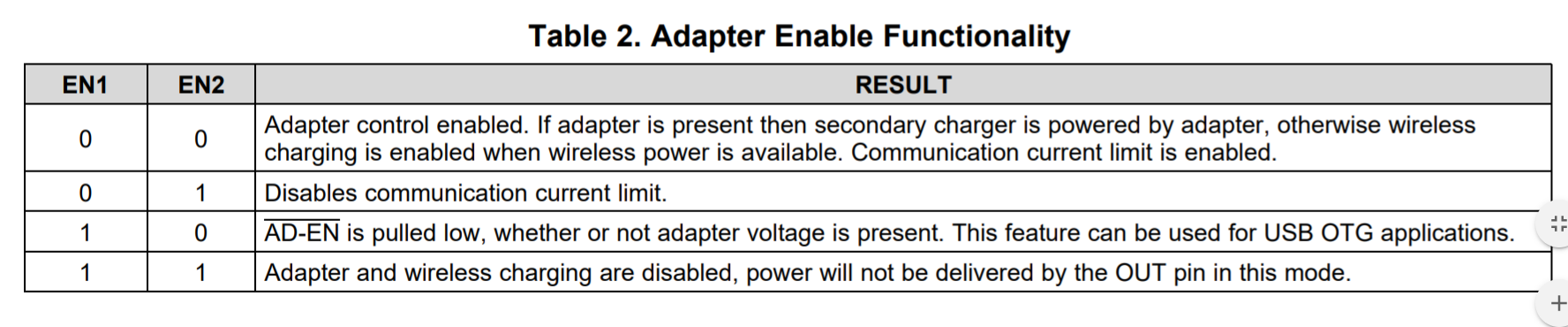

Dear Engineers,
BQ51013B, 当EN1/EN2都为低电平时,是无线充电优先吗?
  • EN1=0, EN2=0 Wireless power and Wired power is working.
    EN1=0, EN2=1 We have both Wireless Power and Wired Power operating. In this mode the Wireless Power is priority, will not used wired power if wireless power is present.
    EN1=1, EN2=0 Wired power is working.
