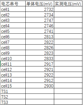

bq76940电压采集异常,cell1~cell5是低5串电压,cell6~cell10采集的电压比低5串电压高,cell11~cell15采集的电压比中间5串更高,
Other Parts Discussed in Thread: BQ76940
如题所示,AFE总共采集15串电压,实际上用万用表测试单体电压是比较一致的,但BQ76940读取的电压异常:cell1~cell5是低5串电压,cell6~cell10采集的电压比低5串电压高,cell11~cell15采集的电压比中间5串更高,这是什么原因?
  • 您参考下面的建议
    a. Be sure the gain & offset are being used. This is a common value for all cells.
    b. Consider calibrating offset per cell at a voltage of interest, or gain & offset
    c. If one or two cell groups are shifted, look at board warpage, try to reflow the part to see if data sheet accuracy is restored.
