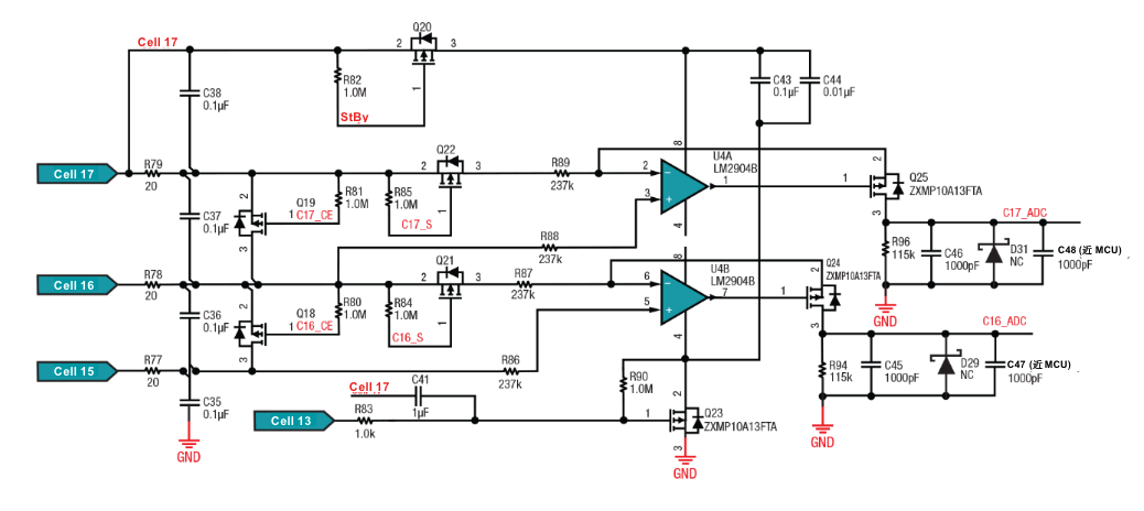

您好,Q18 and Q19 are cell balance transistors for cells 16 and 17 respectively. The gates are connected by net name to a control from the MCU. Balance current is limited by the 20 ohm input filter resistors.
