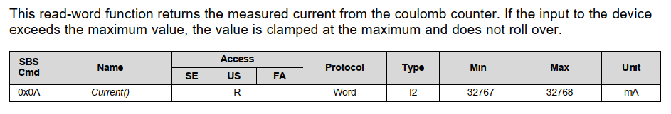

您好,-32767~32767是这个栏位能填入的最大值。如果电流超过需要用到缩放。
Unfortunately, there is a FW bug in scale factor for the bq40z80. We are releasing a maintenance release eventually.
