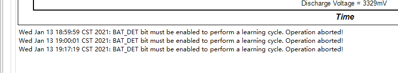

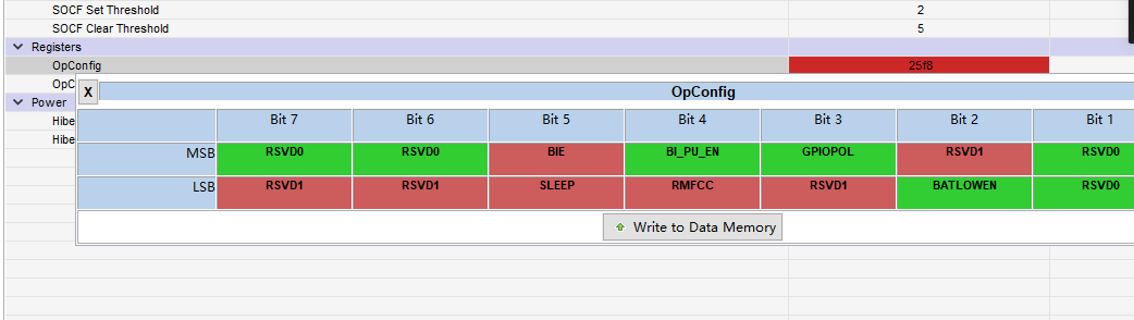

2.电池曲线学习的流程是什么?是否通过EVM板上的 charger+、charger-接充电、或电子负载进行充放电操作?点击start 学习的时候,显示
BAT_DET bit  没有使能,查看config寄存器BIE是高
怎样让它学习。

    2,BAT_DET 请参考TRM Table 4-2. Control() Subcommands
    学习流程如下:
    To perform a learning cycle, after configuring the e Design Capacity, Design Energy, Terminate Voltage, and Taper Rate,
     charge the cells to full, rest for 2 hours, discharge to empty using c/7 rate, rest 5 hourss, charge to full, rest 2 hours and dishcarge to empty and rest 5 hours.
    If qmax_up and res_up flags gets set, then learning was successful and the pack can be used

  • 静止六小时之后 ,下一个阶段是 充电。结果出现
    Fri Jan 15 15:00:29 CST 2021: Learning cycle cancelled
    Fri Jan 15 15:00:35 CST 2021: Error: [RUP_DIS / RDIS: Not Clear]
    Fri Jan 15 15:00:35 CST 2021: Learning cycle cancelled
    Fri Jan 15 15:00:40 CST 2021: Error: [RUP_DIS / RDIS: Not Clear]
    如果调节这个时间,因为已经静置过了。
  • 找到了答复。。
    Do you actually have a load connected to the cells for the discharge to occur. I would recommend not using the learning cycle plug in, but rather, simply complete the discharge and charge independent of the plug in.
    Before starting the learning cycle, set the update status to 3. Update status will go from 3 to 2 to 1 during learning. See the trm for quick start guide for additional details.
    thanks
    Onyx
