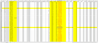

同样的配置下,为什么第一次充电能到达100%,后面又不能到达100%,配置和log数据如下所示,谢谢!

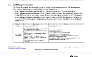

您好,请参考TRM 4.6 Valid Charge Termination
您好,minimum taper charge不建议修改,建议使用默认值。
详细请参考下面的内容。
This parameter is normally a private one. Which version of bqStudio and FW are you using? This parameter should be left default, and is not used in the way you think it is, instead it is used for charge accumulation during the taper window. There is no way you will accumulate 800mA in 40 seconds.
The parameter you want to configure correctly is the "Taper Current". Normally this value is in the C/20 range.
