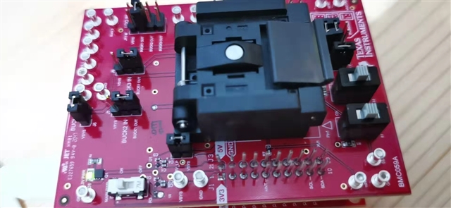

在采用烧录底座更新时序时,在线可以更新,但是掉电重启后有回复原状,没能成功写入到EEPROM里

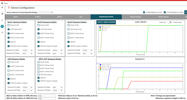

  • 我用的是scrips,最后有进行烧录,但是断电后重启,烧录的内容就没了
    write('CONTROL_LOCK', 0xDD); // Unlock control registers
    write('CONFIG_LOCK', 0xAA); // Unlock configuration registers
    write('GPIO_CTRL',0x02); // Disable configuration CRC
    write('BUCK_LDO_CTRL',0x00); // Turn off all regulators to prevent faults
    write('BUCK2_VOUT',0x0A); // Change Buck 2 output voltage
    write('BUCK3_VOUT',0x1D); // Change Buck 3 output voltage
    write('LDO_VOUT',0X0E); // Change LDO output voltage
    write('SEQ_TRIG_BUCK2',0x03); // Update Buck 2 sequence dependencies
    write('SEQ_TRIG_BUCK3',0x1B); // Update Buck 3 sequence dependencies
    write('SEQ_TRIG_LDO',0x0B); // Update LDO sequence dependencies
    write('SEQ_TRIG_nRSTOUT',0x03); // Update nRSTOUT sequence dependencies
    write('BUCK1_SEQ_DLY',0x61); // Update Buck 1 sequence delay
    write('BUCK2_SEQ_DLY',0x11); // Update Buck 2 sequence delay
    write('BUCK3_SEQ_DLY',0x41); // Update Buck 3 sequence delay
    write('LDO_SEQ_DLY',0x31); // Update LDO sequence delay
    write('nRSTOUT_SEQ_DLY',0x13); // Update nRSTOUT sequence delay
    write('BUCK_LDO_CTRL',0x1F); // Re-enable all regulators
    write('EEPROM_PROG_CMD',0x2D); // Burn settings into EEPROM
