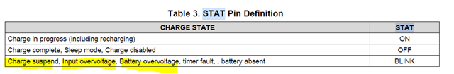

    We are still unclear on the behavior of the STAT pin and the LED. Is it blinking at 0.5 Hz or is it completely off? This behavior will assist in the debugging.
    The safety timer exists as a safety backup to prevent from charging for too long. The maximum time for the safety timer is 10 hours as shown in the datasheet. Again, if you would like to disable termination and the safety timer pull TTC to AGND. If you would like to disable just the safety timer but allow charge termination, pull TTC to VREF.

  • Hi Cherry,
    I am doing the TTC safety timer test.
    Here I have question about charging LED about BLINK status
    1. Whether the charger entry Charge suspend status when TTC safety time over?
    2. How to distinguish with Charge suspend / Battery overvoltage/ Input overvoltage when STAT output BLINK?
    Input overvoltage is charger output voltage?
    Battery overvoltage is battery output voltage?
    3. Do I need a EV2400 to learn battery registor status?
    Thanks.
  • Hi Dear,
    1. When the safety timer expires it is considered a timer fault; charge will stop and the STAT pin will blink.
    2. The STAT output alone will not tell you which of the five (charge suspend, input overvoltage, battery overvoltage, timer fault, and battery absent) is happening. In testing, you can realize these faults by observing the circuit behavior. Input overvoltage is determined by the voltage on the OVPSET pin and battery overvoltage is discussed in Section 9.3.17. Charge suspend can be observed by the TS pin voltage.
