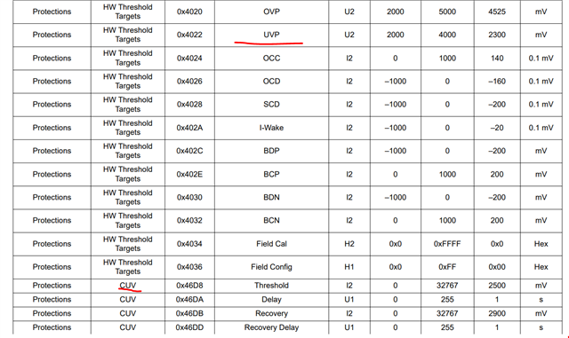

请问,在测试BQ27Z746时,软件保护都没有问题,但硬件保护( HCUV, HCOV, HOCC, HOCD 和 HSCD )不动作,一直都是软件保护动作,是怎么回事
  • 您好,硬件保护值一般都比软件保护值更低或更大,例如下图的UVP,CUV
    TRM中描述到All hardware-based protections are either enabled or disabled, which is based on the configuration image stored in secure memory.
