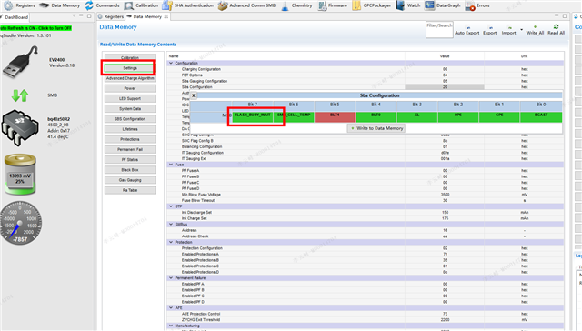

您好, If you have the FLASH_BUSY_WAIT bit set the gauge should clock stretch longer in order to still complete the packet, if the host cannot do this then it can lead to errors.
