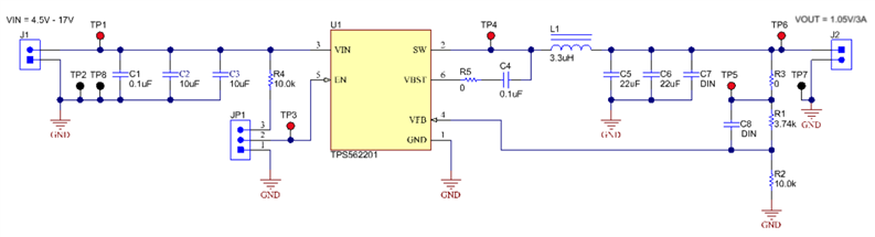

I don't know how to test the open-loop bode diagram according to the EVM.
Based on the traditional method, a small-signal is injected between R3, and the TP6/TP5 is chosen as the input.
However, according to actual measurement, the bode diagram is abnormal, the magnitude characteristic begins from 0, instead of high DC gain.
