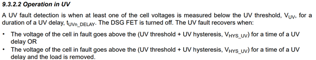

我是的BQ7791501这个型号的保护芯片,在实际测量中触发了过压和欠压保护后,恢复的条件是什么,是某单节电池电压低于或者高于什么电压,实际测量时每次恢复的电压不一致
您好,The UV fault recovers when:
• The voltage of the cell in fault goes above the (UV threshold + UV hysteresis, VHYS_UV) for a time of a UV delay OR
• The voltage of the cell in fault goes above the (UV threshold + UV hysteresis, VHYS_UV) for a time of a UV delay and the load is removed.
