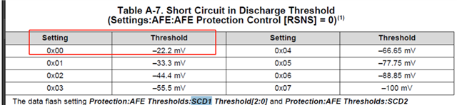

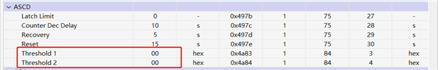

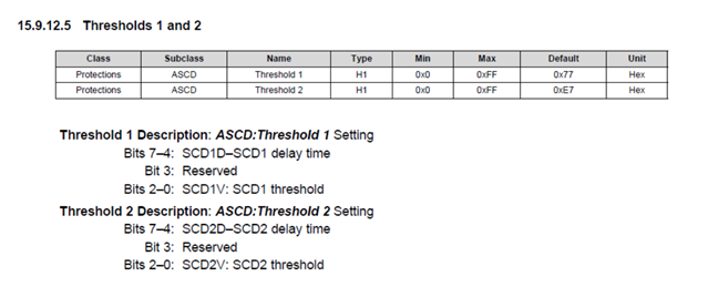

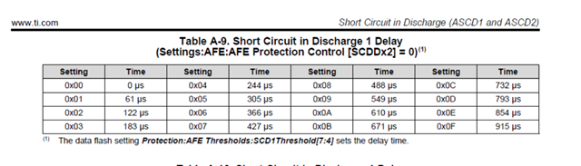

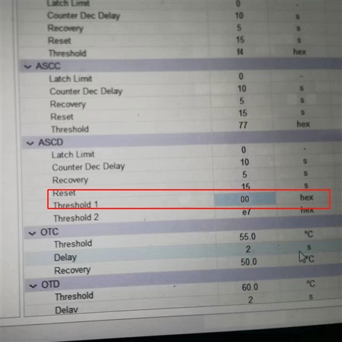

如何修改短路保护的时间,怎么操作?

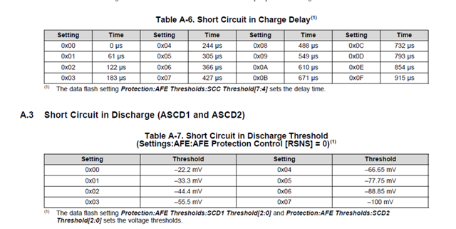

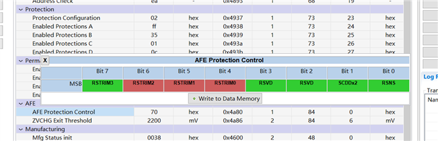

您好,The hardware protections use preset comparator voltage thresholds on the current sense pins, SRN and SRP, to determine a fault. It should be noted that the value programmed according the AFE Threshold and Delay settings will have the tDETECT time added, which should be accounted for when setting the hardware thresholds, especially the Short Circuit in Discharge (SCD) delays.
Please see this FAQ for examples.
您好,建议您用评估板参考下面的例子,做一下验证。
e2e.ti.com/.../faq-what-are-the-differences-between-the-hardware-and-firmware-protections
