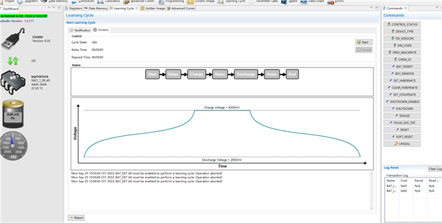

为何27441无法进行learning cycle且总显示 BAT_DET bit must be enabled to perform a learning cycle. Operation aborted!

您好,如果 BAT_DET 为 0,电量计将不会学习任何内容。请参考TRM 2.5.4 Battery Detection (BIN), TRM: www.ti.com/.../sluuas7b.pdf
