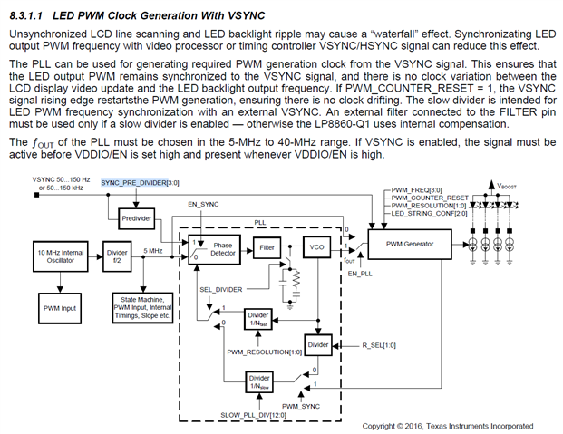

I used "LED PWM Clock Generation With VSYNC" function of LP8860-Q1,  VSYNC is 60HZ
Is there a range requirement for the minimum on and off time for the VSYNC signals?
How long a high level VSYNC signal must last at least?
How long a low level VSYNC signal must last at least?
Thank you

  • 您好,
    如数据表中所述,该器件由 VSYNC 的上升沿触发,对高电平和低电平没有特定要求。
    如果 PWM_COUNTER_RESET = 1,则 VSYNC signal rising edge 重新启动 PWM 确保没有 clock drifting。
