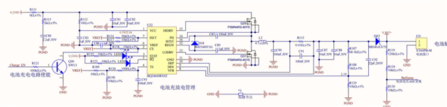

您好
集成电路的功耗主要来自LDO,栅极驱动器以高频驱动FET。有关如何减少热量的建议,请参阅相关帖子:(+) BQ24600: Chip Heating Up - Power management forum - Power management - TI E2E support forums
