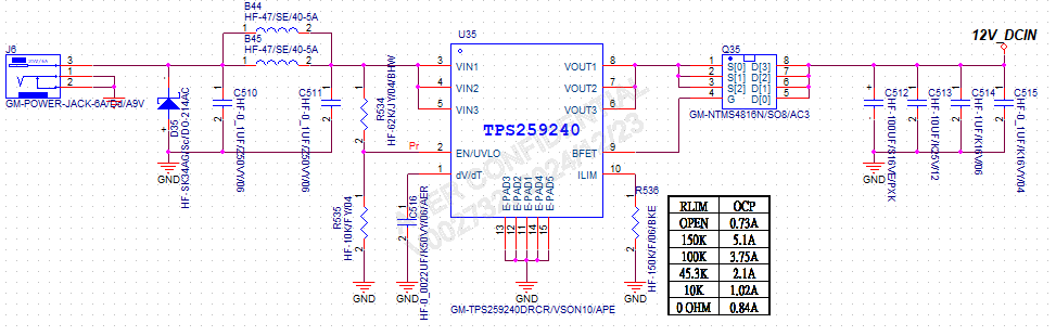

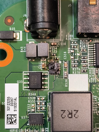

"The TPS259240 is burned out. Measurements show that PINs 3, 4, 5, 6, 7, and 8 are shorted to ground. Please help verify if there are any issues with the circuit design. There have already been more than ten cases reported in our product."
