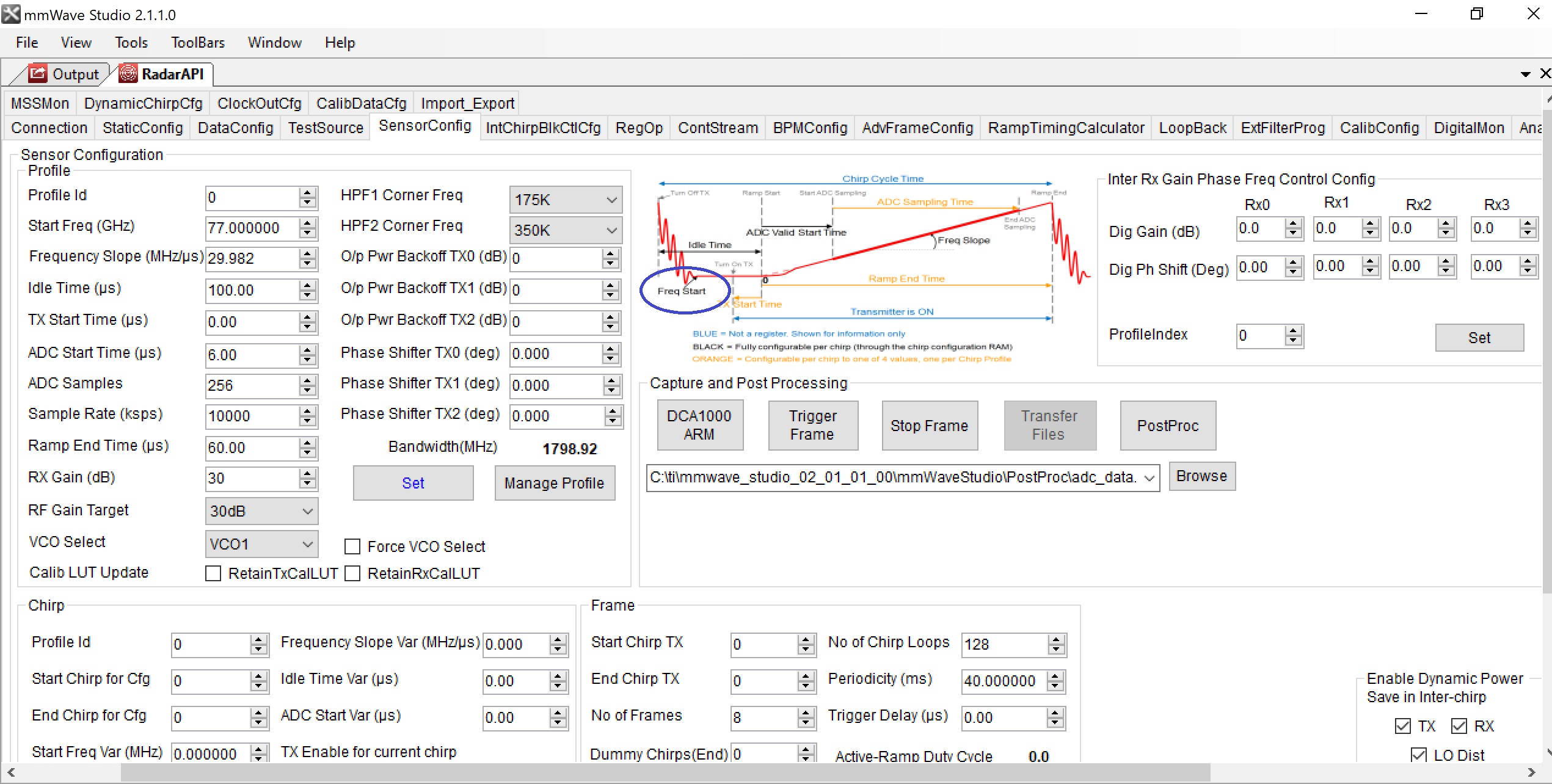

您好!如题
但是有这样描述:mmwave_studio_user_guide.pdf
21.4.2 Calculated parameters This is a useful list of parameters that are calculated using the programmed parameters. They include d. True start frequency ramp. The programmed start frequency doesn’t take into account the ADC start time. When the ADC start time is taken into consideration, the true start of the ramp happens a few microseconds after the programmed start.
