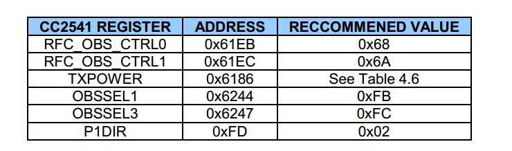

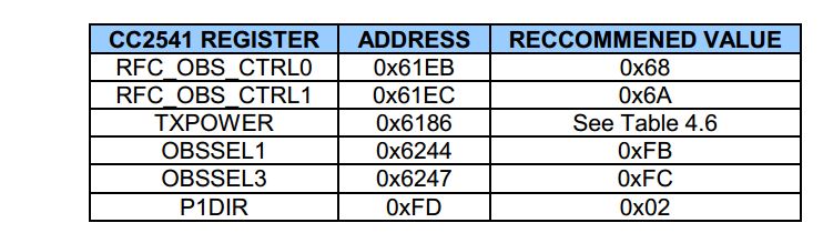

如题CC2541 CC2590的例程有吗?
请下载BLE stack,The TI BLE software stack supports CC2590 and the automatic control is enabled by the use of HCI_EXT_ExtendRFRangeCmd. This command is used to configure the CC254x to automatically control the CC2590. Once this command is used, the configuration will not change unless the CC254x is reset.
