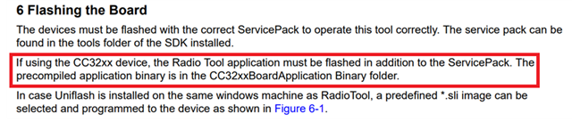

请问该芯片CC3235SF的无线测试工具RadioToolGUI使用说明说有没有?
  • 当时我使用这个软件,点击connect时候跳出来这个错误“there seems to be an error when trying to retrieve deivce information.this means the device may not have been flashed with the proper FW or application(if using3220),and thus radio testing may not function properly.Please check and make sure your board is flashed with the correct FW and application.For more information,please refer to the wiki page for instruction.”请问是哪里出错了?这个板子我已经使用unflash烧录过了
  • 您好,
          报错是说板子没有烧录可与GUI通讯用的固件。
          您烧录的是哪个固件?测试的是哪个板子?
  • service_packfile:sp_4.11.0.0_3.7.0.1_3.1.0.26.bin MCUImg是我写的一套wifi程序,板子是LAUNCHCC3235MOD

  • 您好,
  • mcu img 选择“C:\ti\CC3xxx_RadioTool_1.0.3.19\Source Files\Precompiled Binaries\radiotool_CC32xxSF_LAUNCHXL_tirtos_ccs.bin文件烧录进去就好了
