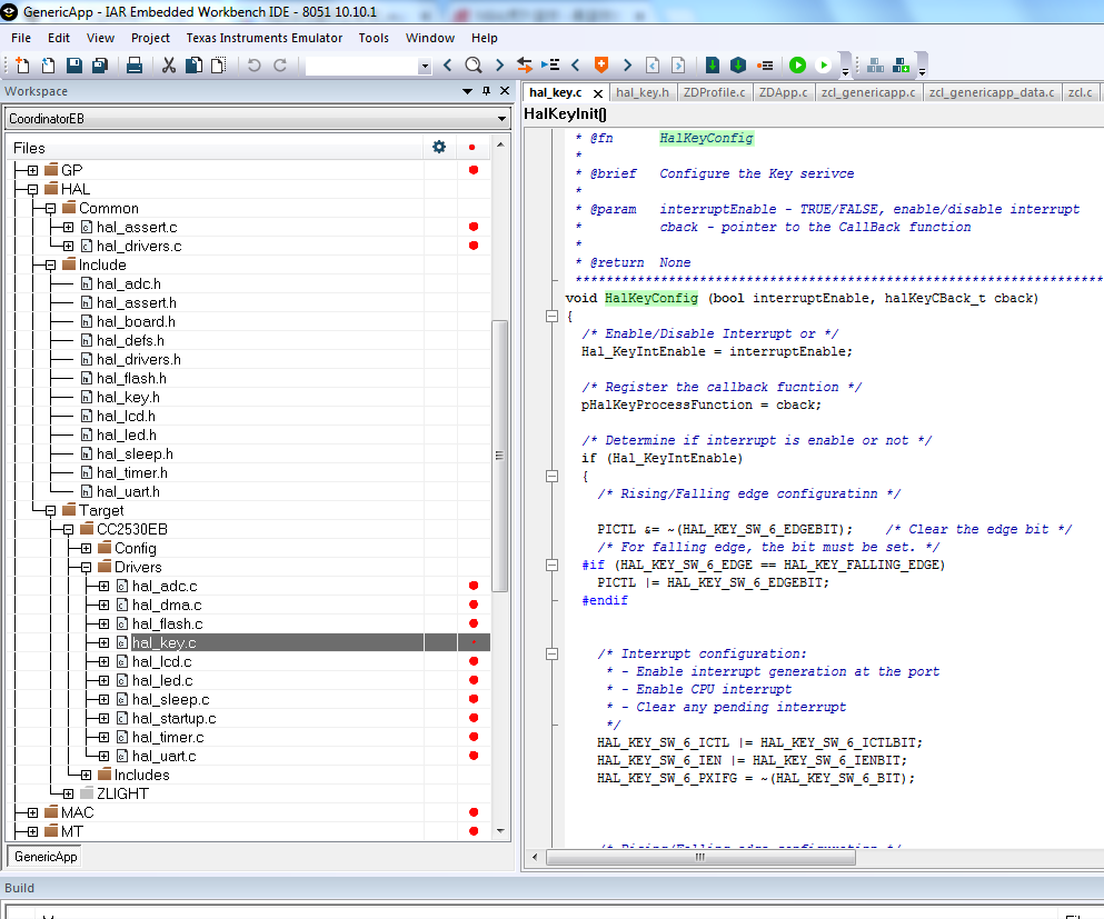

你好,CC2538基于3.0HA的协议栈,实现按键的长按短按识别,
代码如下,可是实际上得不到想要的效果,
按键的中断和查询方式在哪里设置?
static void zclSampleDoorLockController_HandleKeys( byte shift, byte keys )
    (void)shift; // Intentionally unreferenced parameter
    if( keys & HAL_KEY_SW_1 )
      keyPressTime = osal_getClock();
    else
      if ( keyPressTime )
         keyPressTime = ( osal_getClock() - keyPressTime );
        if ( keyPressTime < 3 )//小于3秒,短按
          NLME_PermitJoiningRequest(30);//允许加入
        else //大于3秒,长按
          //恢复出厂设置
          zgWriteStartupOptions( ZG_STARTUP_SET, (ZCD_STARTOPT_DEFAULT_NETWORK_STATE | ZCD_STARTOPT_DEFAULT_CONFIG_STATE) );
          SystemResetSoft();
          keyPressTime = 0;
