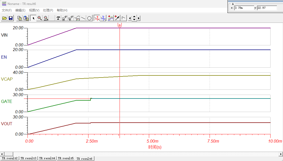

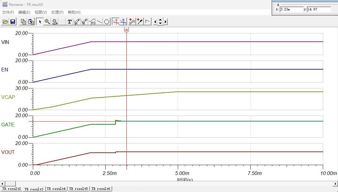

通过仿真,在改变负载电阻和输入电压后,发现GATE输出电压总是仅高于输入电压2.97V

我是想知道GATE引脚输出电压,是由什么决定的

比如在完全导通模式下,GATE电压永远仅比输入电压高2.97V
根据datasheet说明这个不是处于完全导通的模式下,以下帖子有相关说明
您好
For the LM74700-Q1 to operate in full conduction mode the gate driver must be enabled as described in the Gate Driver section and the current from source to drain of the external MOSFET must be large enough to result in an ANODE to CATHODE voltage drop of greater than 50-mV typical. If these conditions are achieved the GATE pin is internally connected to the VCAP pin resulting in the GATE to ANODE voltage being approximately the same as the VCAP to ANODE voltage. By connecting VCAP to GATE the external MOSFET's RDS(ON) is minimized reducing the power loss of the external MOSFET when forward currents are large.
