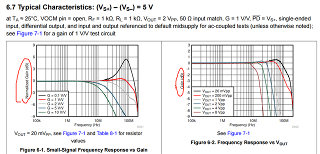

Part Number: THS4552
hello,
What are the differences between the normalized gain and the gain of an operational amplifier?I couldn't find the curve representing the gain bandwidth of the major signal in the manual. I'm wondering where the bandwidth parameter for the major signal output in the data sheet comes from.
