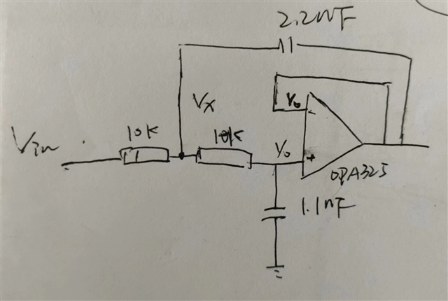

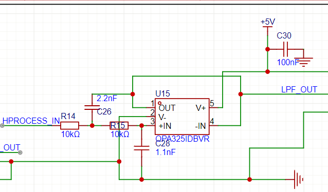

Part Number: OPA325
A Sallen Key low-pass filter designed with OPA325, with a cutoff frequency of 10KHZ. Designed with reference to TI's data sheet and related low-pass filter manuals. Software simulation is fine, but the actual hardware test gives a DC signal of 3.3V that is directly attenuated to about 0.7V. +5V power supply. And there is no DC bias
