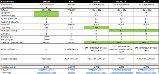

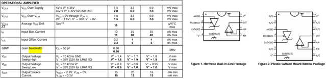

LM611 has an op amp + voltage reference. there is no direct replacement for the part. You have to find an op amp and reference voltage IC replacement.
if you tell me the application, maybe I will find a close replacement. OPA196/OPA197/TLV2797-Q1 should replace LM611CM part based on the functionality.
For voltage reference, you may consider TL431, LM4040, REF35 or other reference voltage.
https://www.ti.com/power-management/voltage-reference/products.html
Please provide me the cost and application requirements, I will find you a suitable replacement.
