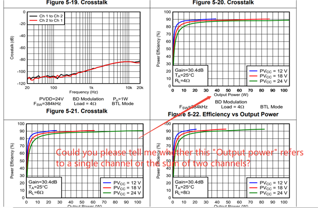

请问TAS5830 Datasheet上Efficiency曲线上
的output power是指单个声道还是两个声音加起的?

您好
• Supports multiple output configurations – 2 × 80W, BTL Mode(4Ω, 26V, THD+N=10%) – 2 × 65W, BTL Mode(4Ω, 26V, THD+N=1%) – 2 × 74W, BTL Mode(6Ω, 30V, THD+N=10%) – 2 × 63W, BTL Mode(6Ω, 30V, THD+N=1%) – 1 × 151W, PBTL Mode(3Ω, 30V, THD+N=10%) – 1 × 131W, PBTL Mode(3Ω, 30V, THD+N=1%)
根据datasheet中这部分说明,这个是在单通道下进行测试
