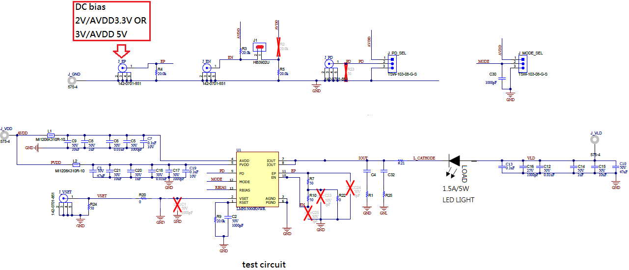

Hello:

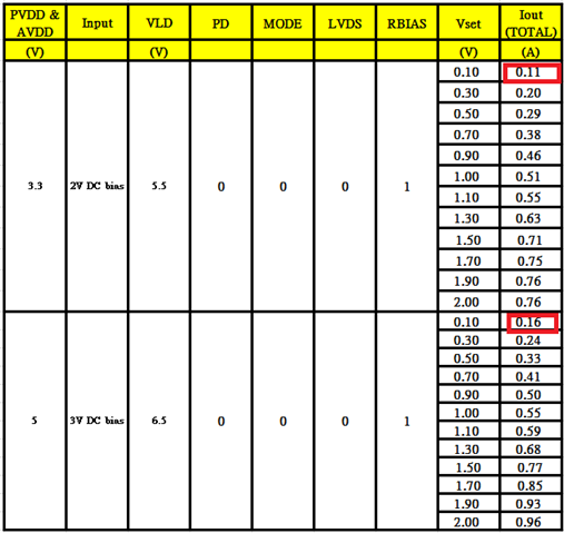

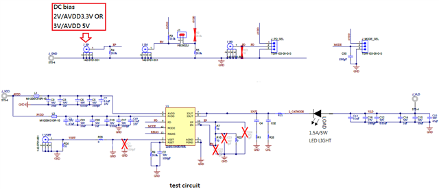

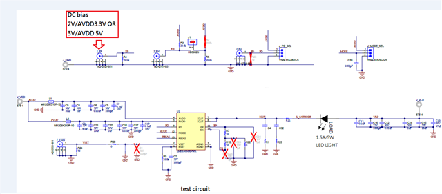

LMH13000RQE Evaluation test circuit:

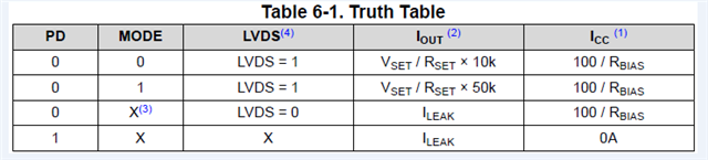

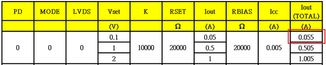

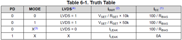

Spec calculation formula

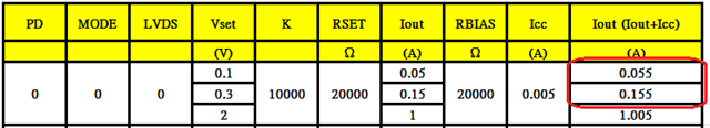

Estimate based on formula

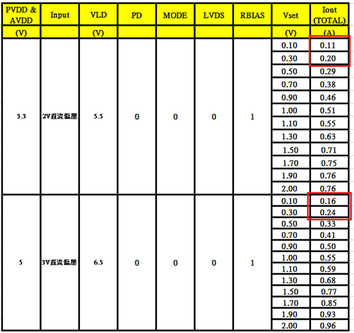

Iout Test Results:
The test results of the development board are different from the calculation formula.
Is there a problem with the circuit wiring method or design parameters, or is the development board damaged?
規格書公式列表:
