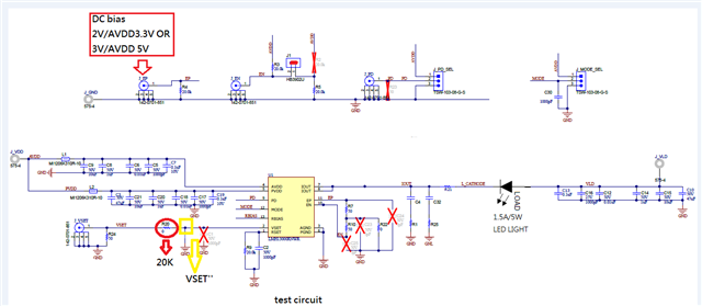

Hello,According to the suggestion:"datasheet 19 page “The VSET voltage is applied using a DAC through a 20kΩ series resistor."
As shown below
test circuit :
Correction Problem Description
Test Circuit Setting conditions:
single-ended input;DC bias 2V/AVDD 3.3V
(PD = 0);(MODE = 0);(RBIAS=1);Low-Current Mode
The iout current is also locked and cannot be controlled by VSET,VSET'' voltage is locked 2.1V
Is there a problem with the circuit wiring method or design parameters, or is the development board damaged?

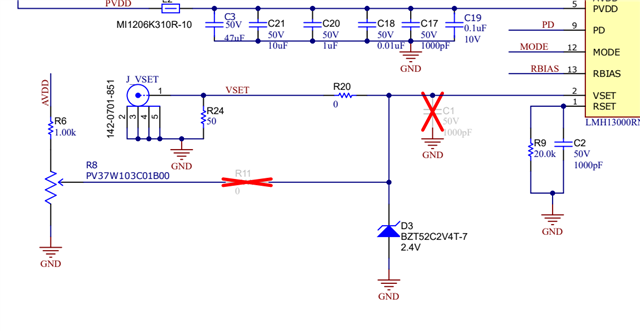

    What voltage input are you giving at VSET pin from DAC. Please note for full range of current in both the Mode, the max VSET which is acceptable and recommended is 2V only.
  • Hello, if the development board's AVDD is powered by 3.3V and the VSET input voltage is 0V, then the VSET" terminal (as shown in the circuit diagram above) will have a voltage of 2.1V. Is this normal?
  • Hi,
    Below is the schematic of EVM's VSET input structure. Please can you check and confirm if your customer has populated R11 resistor? By default is it not connected in EVM. But if it is connected the potentiometer R8 state will decide the VSET" voltage.
  • Hello, I tested the LMH13000RQE development board and confirmed that R11, R24, and D3 were removed.

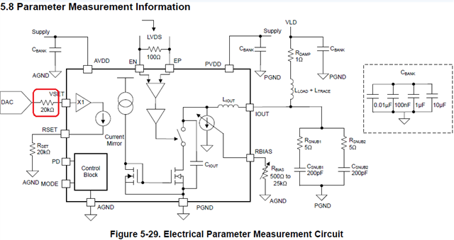

  • Hello,According to the suggestion:"datasheet 19 page “The VSET voltage is applied using a DAC through a 20kΩ series resistor."R20" "0R=>20K"
    Is the circuit design with a 20kΩ series resistor for the DAC only suitable for high-current mode with a V105Q121A-940 laser LED as the load?
    Or is it necessary in all situations?
  • Hi,
    The 20kohm is not necessary. Not having the 20kohm resistor will only cause a offset current error of few 10s of uA in the output current.
    The VSET input pin a high impedance input, so the current going into the pin will be <100pA. So if there is a voltage drop of around 2.1V across the R20 resistor, probably the device may have got damaged. Can the customer replace the LMH13000 device on the EVM and check once. Also I will suggest not to remove D3. It acts a protection against high voltage applied to VSET pin. Please note the absolute maximum rating for VSET pin voltage is 2.5V. Any voltage above that can damage the device.
  • Thanks for reply,
    Ask again
    When AVDD 3.3V R20 is 20K in the circuit diagram, there is no VSET input. At this time, the measured VSET pin voltage is 2.21V.
    When AVDD 3.3V R20 is 0R in the circuit diagram, there is no VSET input. At this time, the measured VSET pin voltage is 0.01V.
    Is this situation normal? probably the device may have got damaged.

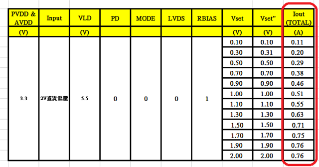

    Is the Iout test data correct?
  • Hi,

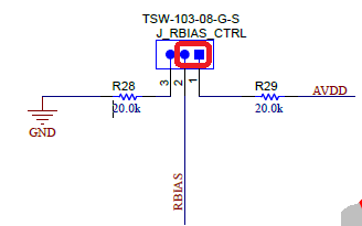

    Are you in low current mode (MODE=0) or high current mode (MODE=1)? Also is there any resistor connected to the Rbias pin? Those will both change the current output range.
  • Thanks for reply,
    Test situation:
    In low current mode (MODE=0) And Rbias pin short pin1&pin2 Connect to AVDD.
    Are the test data correct?
  • Hi,
    The output current in mode0 should be Iout = [ Vset(V) * 0.5 ] A.
    I believe there is is current clamp of ~0.75A  at the VLD power supply that is why the current is not going above that value. Can you confirm this.
    And at lower vset I am seeing around 40-50mA of extra current. So can you please also check what is the current measurement accuracy for IOUT.
