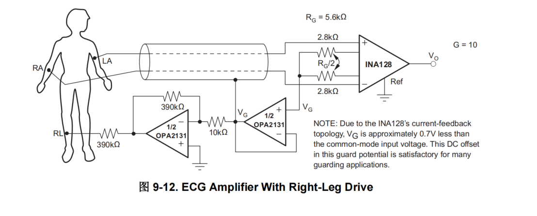

INA128: The common mode voltage of Rg
Part Number: INA128
Other Parts Discussed in Thread: OPA2131, , INA828
It was described in the datasheet that the Vg is 0.7 V less than the common-mode voltage. However, it may cause the drl amp(the opa2131 in figure) saturate. As a matter of fact, this may lead to the failure of the drl feedback. And I need a INA amp to collect EEG as well as can provide  Vg almost the same as the Common-mode voltage, any recommendation?image.png
