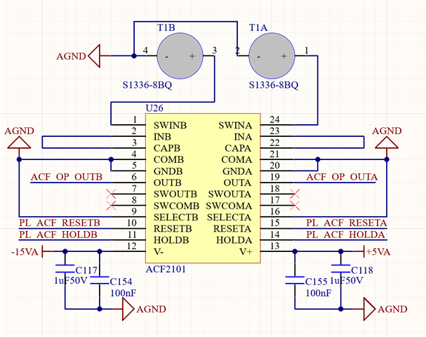

  • I am using the ACF2101 chip to perform photodiode output current-to-voltage conversion. The circuit design is shown in the figure, with the S1336-8BQ photodiode's anode connected to the SWIN pin of the ACF2101.
    When there is no light, the output of the ACF2101 is +380mV. How should I interpret this phenomenon? Additionally, could you help verify if the placement of the photodiode in the circuit design is correct?
  • The photodiode configuration looks correct with the anode connected to the SWIN pin and the cathode connected to ground.
    Could you clarify how low of a current you are trying to detect in the low-light conditions?
    Is the output of +380mV a measured or simulated value? If this is measured, have all the possible leakage currents been mitigated? Such as clean PCB board and guard patterns. This device has a very low input bias current but leakage currents can cause additional errors.

  • We are using the ACF2101 to detect the current from a photodiode (Hamamatsu S1336-8BQ). In our application, the light source flickers at 50 Hz. During each illumination period, we control the ACF2101 to integrate the output current of the photodiode with an integration time of 2us.
    Our testing shows that under no-light conditions, the maximum output voltage from the ACF2101 can reach +380 mV. As light intensity increases, the output gradually shifts to negative values. We recognize a flaw in our PCB design: the lack of an input guard ringis likely introducing noise. Could TI provide a hardware evaluation board for the ACF2101 to assist with our debugging and validation?
