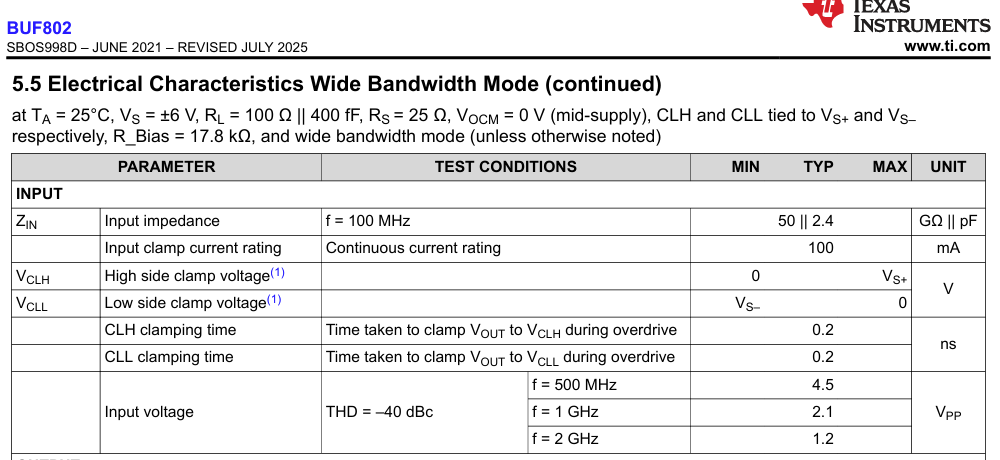

I used BUF802 in my design, V+ was connected to PP8V5,V- was connected to PN4V5. In datasheet input range spec. is 4.5Vpp@450MHz, what is range BUF802 support? May input range set to 6Vpp?

您好,
我有关注到datasheet里面提到4.5Vpp@450MHz
应该是是4.5Vpp@500MHz吧
我可以牺牲带宽去满足这个输入范围吗?
从电平上来说,芯片是支持的。您可以选择牺牲带宽,建议您先仿真一下。
