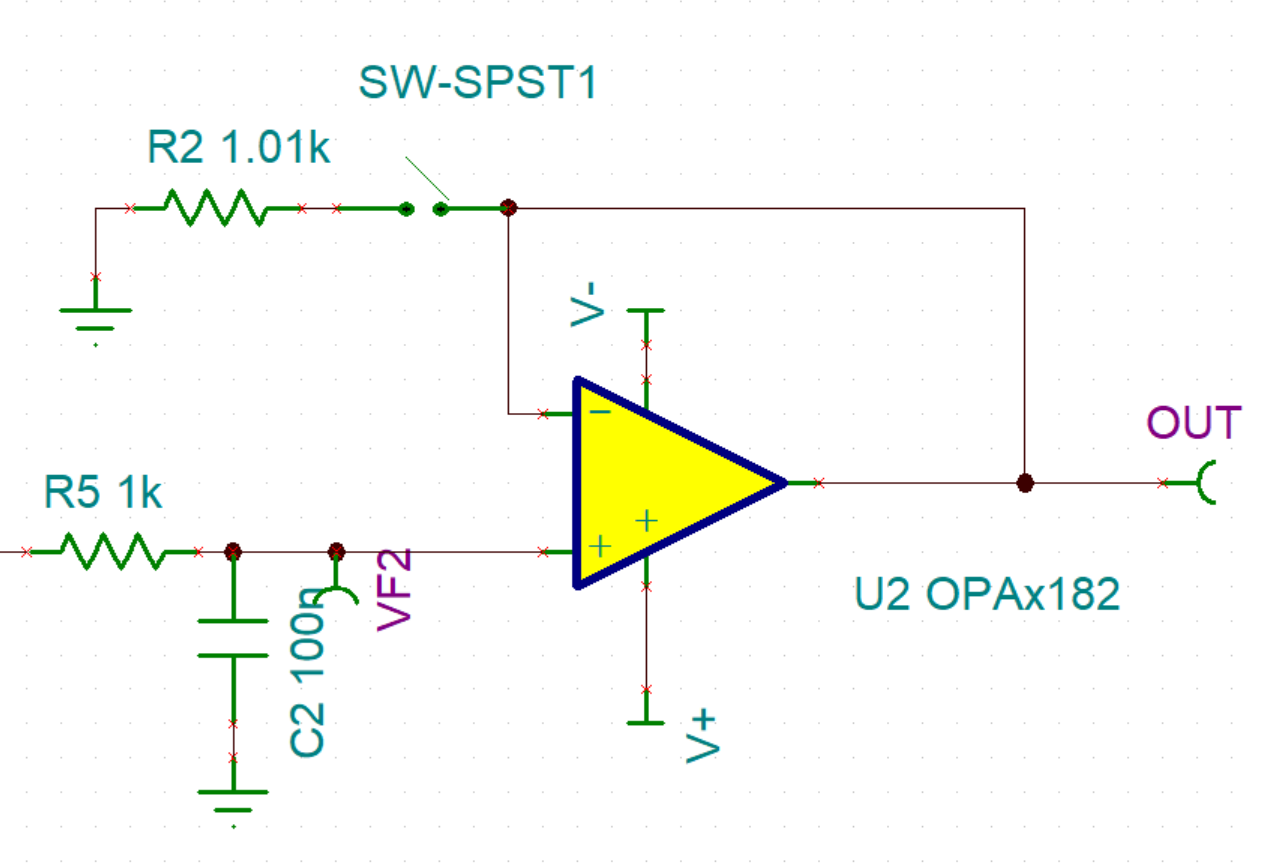

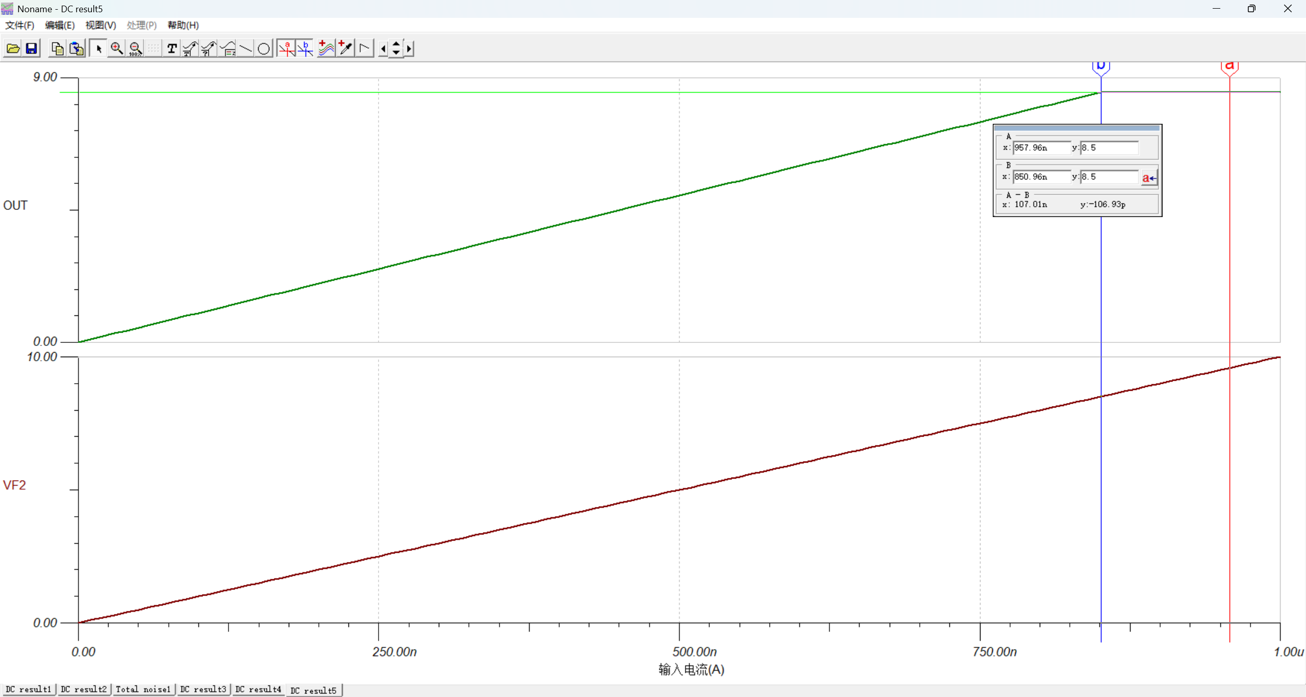

正负11V供电的话,输入电压需要满足Common-mode voltage range的要求,(V–) – 0.1 V ≤ VCM ≤ (V+) – 2.5 V
