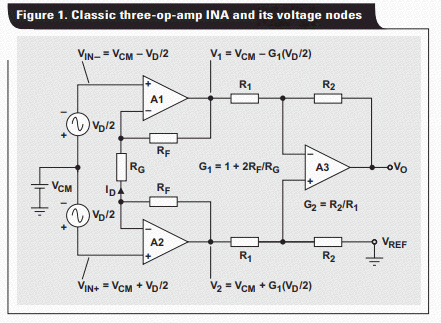

I have a 0~20mV differential signal ,input common-mode voltage is 12V,signal  bandwidth is 10MHz。target Gain is 25V/V,output common-mode voltage is 0V。
I select three OPA891 form an instrument amp as the schematic below。
In the first stage,choose Rf=7Rg,let G1=15。bcause GBW of OPA891 is 180MHz,signal bandwidth is 10MHz,let -3dB Gain  above 10MHz.
In the second stage:choose 25*R1=15*R2,ie G2 is about=1.667,let G=G1*G2=25
please give me some .advice on my design。
