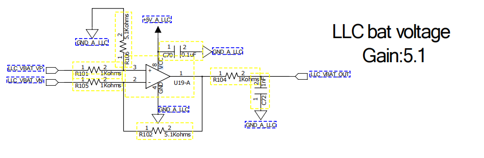

I'm using the TLV9062 to build a difference amplifier with a designed gain of 5.1 V/V.
Setup:
  • V+: 5V
  • V-: GND (Single Supply)
  • Topology: Standard 4-resistor difference amplifier.
  • Input Signal: 1kHz Sine wave.

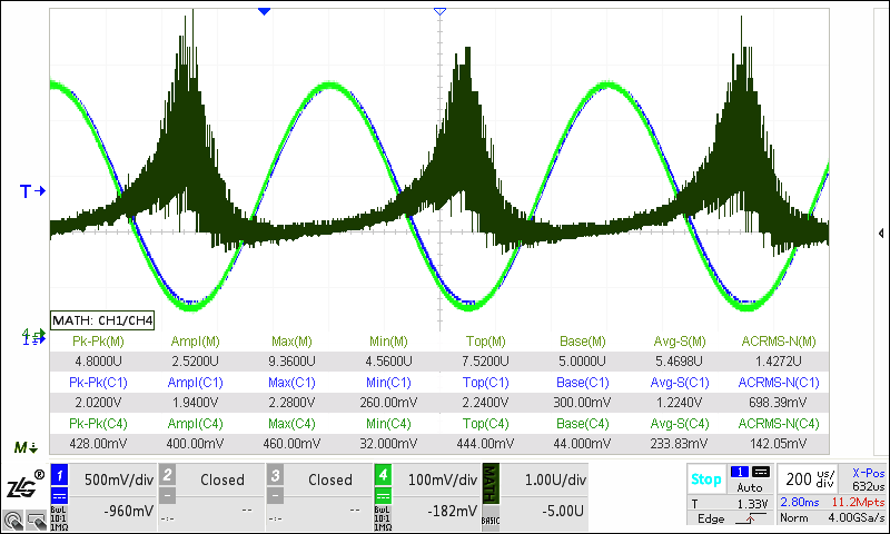

During testing, I noticed that the gain spikes significantly when the input signal approaches the negative rail (GND).
Measurement Screenshot Observation:
  • CH4 (Green): Input signal from function generator.
  • CH1 (Blue): Output of the TLV9062.
  • Math Trace (Dark Green): Calculated Gain (CH1 / CH4).
As shown in the attached waveform (screenshot attached), at the valley of the sine wave (approx 40mV input), the measured gain jumps to around 9 V/V, even though the design target is 5.1 V/V.
