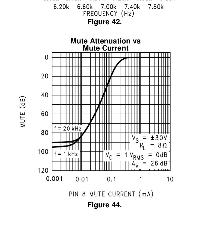

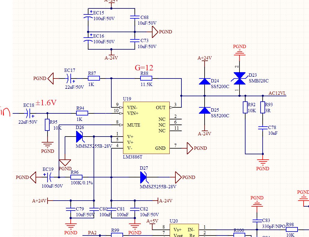

hello  when I  use  LM3886T like a  driver, How was The  mute  pin (Pin  8)   effect   distortion。
when I give R96 a value  100k,The output  pin 3   gives plot like 100K.rar.
when  R96=39kΩ   ,output  looks like   39K.rar
my  circuit:
mute :
39k.rar
100K.rar
I'm confused why mute would cause waveform distortion?Shouldn't it be overall attenuation?
